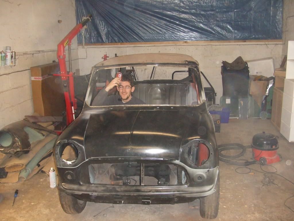

Hi there, I have fitted these, I made a visit to Somerford mini to get advice on fitting I was advised to use the door bolt holes for alignment and the front suspension top mount bolt holes I then built up my front end using self tapping screws to make sure everything worked together ok plus obviously fitting the bonnet,I then spot welded everything together. As far as my doors I re-skinned both my doors and everything still worked ok when it came to putting it all back together.
You could bolt the door on once the complete inner wing assembly has been clamped in place just to check the shut line against the a-panel

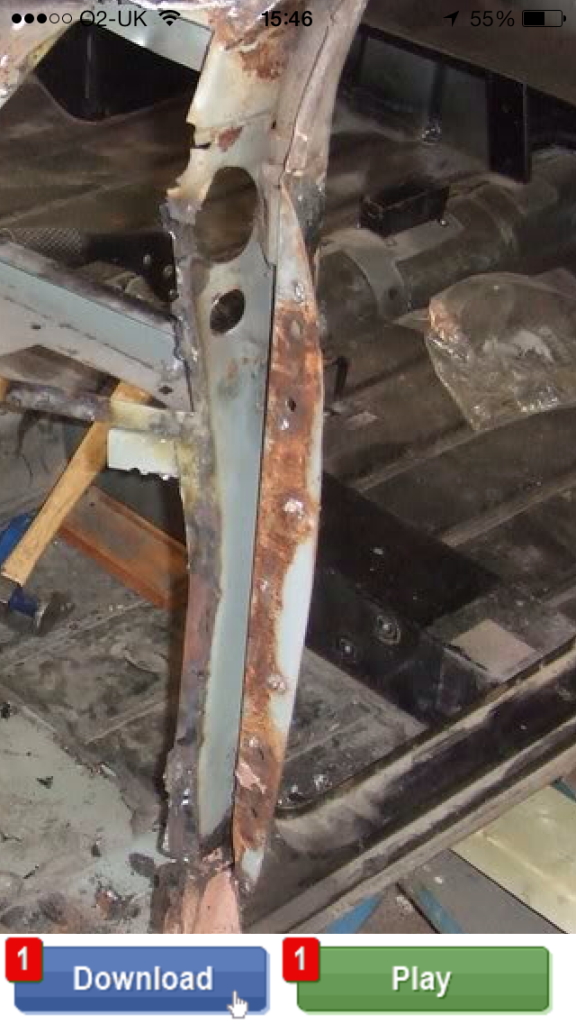

The area around the door hinge holes is made up of two panels, so even with the inner wings removed the holes for door hinges will still be present
This is with the front end built up
Edited by corrado vr6, 07 August 2014 - 02:54 PM.

Also, that front end looks fantastic.  It also looks like it's had a few other new panels!
