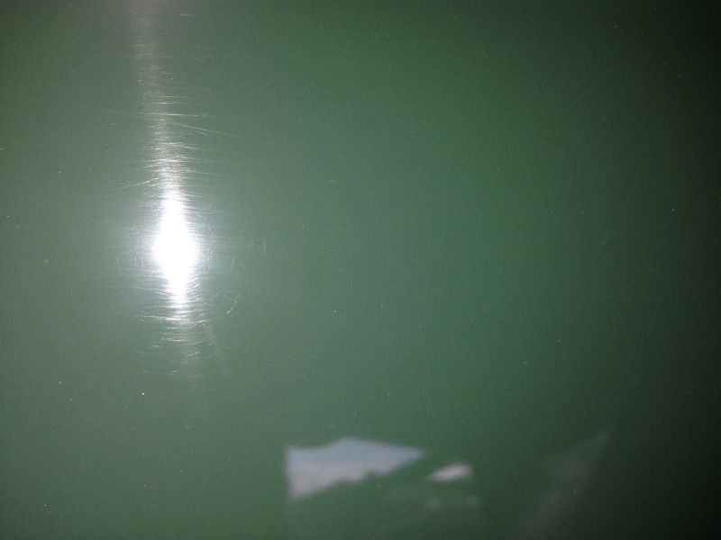

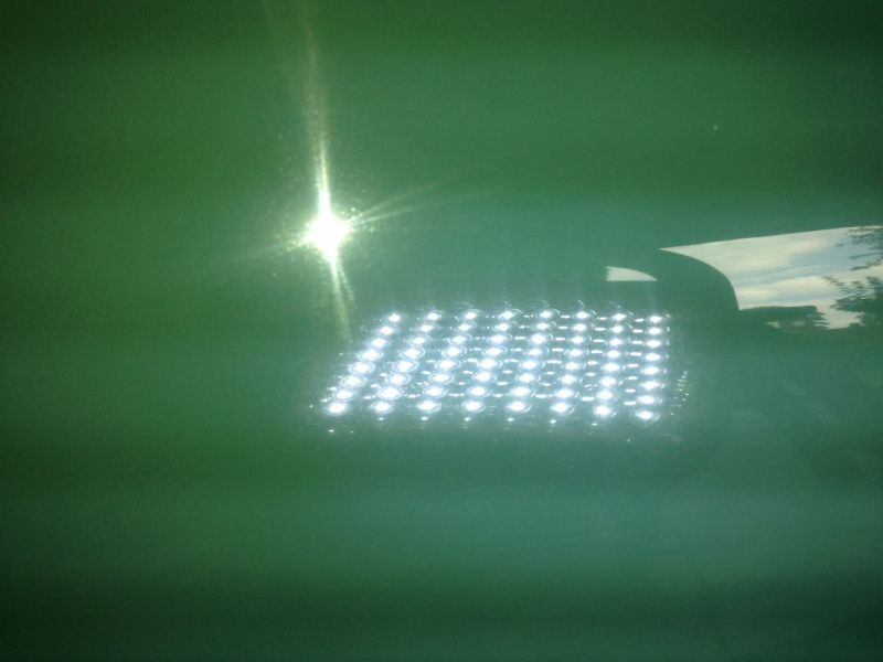

As you can see they are very minor and probably no more than most would consider a correction on a car been used a while, not easy to photo though

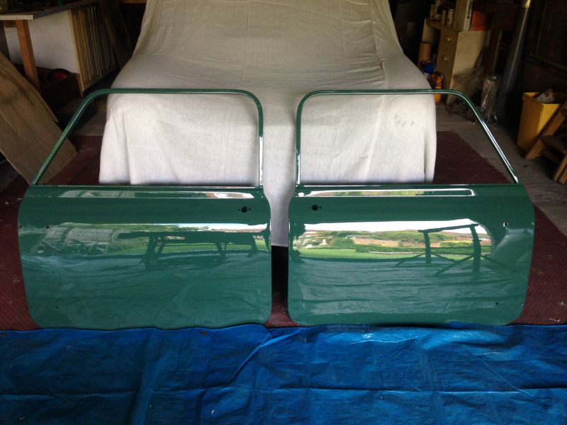

And a pic of a door showing the general appearance of a freshly painted panel before I did any sanding so no real paint problems to worry about,

Are you using enough compound?
Plenty of compound on a damp-wet pad using slow side to side movements with slight pressure should do it. Keep the pad wet with a spray bottle and keep going until the compound is cleared up.
You can finish up with a machine glaze or hand glaze if you prefer.
Other than that, i don't know what to suggest

We had this problem when the 3M trizak came out (similar method to what you used) and was why we stopped using it..
Before you give up and do it again.. I'd try the G4 it's a much harsher compound.. Put a bit of weight on it, and get the panel warm..
Edit:- yes as Ben says plenty of compound..

What speed is your buffer on? its the first question to be asked.
Flat the panel with 1000 w&d using soapy water until the scratches disappear then go over again using higher grade w&d then wet the panel again and buff on a slow speed.
G3 is a good machine buffing paste, g4 is for hand buffing.

i looks like you just need to keep going over it with a mop on position 2.5/3.0 speed wise it took me 6.5 hours to polish my bmw bonnet alone and i used g3 on it it also could be you're mop head scratching the paint not enough compound build up on the mop head
