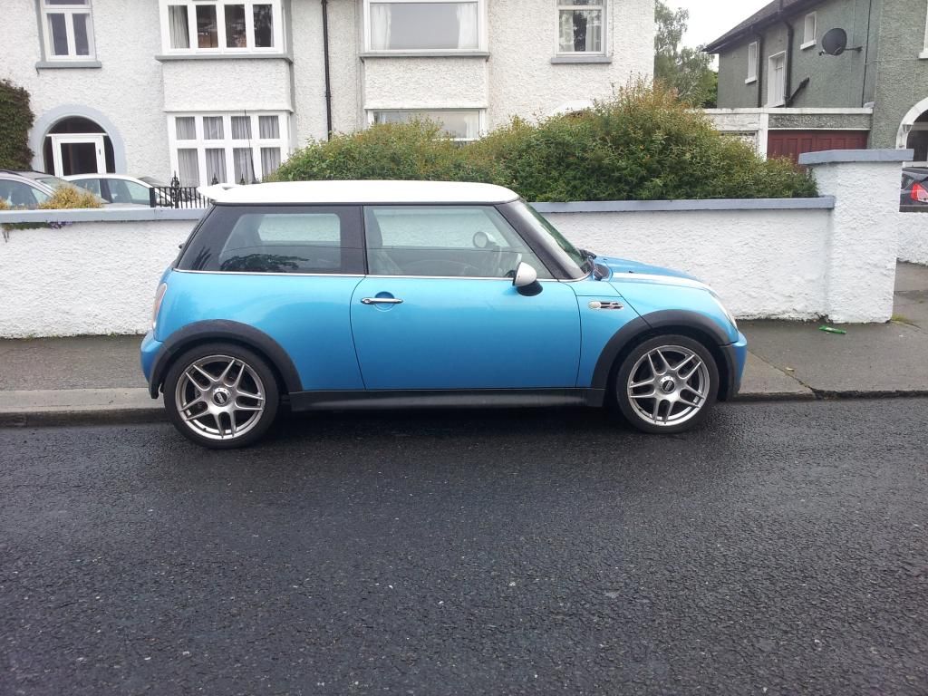

Just came across this forum while scouring the web for a fix to my wheel rub problem and after a bit of a search I can see others with the same problem but with no solution :D
So the car has 17" BBS wheels fitted with I think 205/40/17's (need to double check) and they're non RF's.
Basically with someone in the rear seat the wheels rub on bumps or fast bends. I'd imagine the solution is stiffer springs or even just taller ones but I'm not sure which to go for.
Not looking to fit coilovers or anything as I want to keep it stock.
Anyone any ideas?
Here's a pic when I got it, it has he run flats in this on it but the ride height still looks the same when stationary
