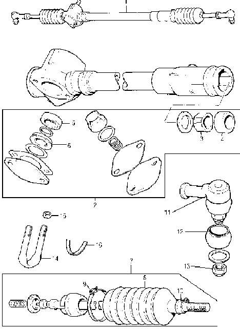

Quick question I've been doing some looking around.
http://www.minimania...minicat8-21.jpg
According to this diagram there should be a nylon bearing and a seal. Neither of these I have on either side. Seems strange to me unless I am looking at an older assembly.
I also found no evidence of grit in the rack what so ever.
I've found strange things done to this car before and I just want to make sure I'm not missing bits.
