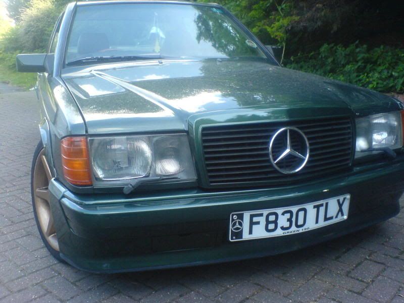

Well this is the grille off of my old car and the frame was chrome and i wanted it body colour. all i did was remove the grille ornament, weld the hole up, go over it with a 320 disc on a DA and then a couple of coats of Acid etch, then a few coats of high build, flat back and on with body colour. If done thoroughly it will last well as mine did.
Good luck!
Ben
