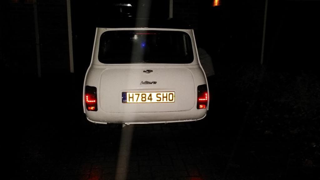

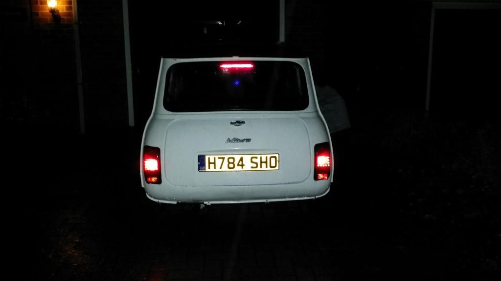

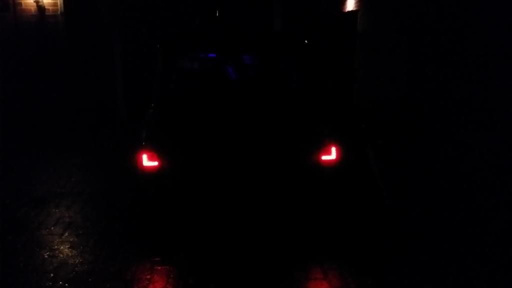

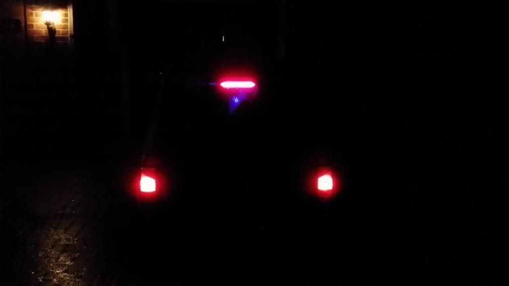

Sorry for the late reply, got some photos of the LED real lights at night
Side lights with flash
Without flash
Brakes without flash
Brakes With flash
As you can see there is a clear difference between the two as well as my top level brake light for extra safety
Any questions just send me a message
Lawrence
