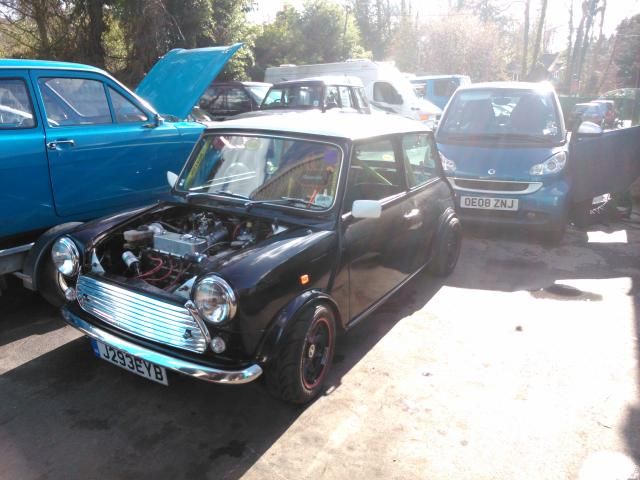

A year ago I felt I needed to keep the ethusiasm going and Ive always loved minis, my dream toy is a hayabusa z cars mini, one day, maybe when the anglias done. This mini came up for sale just down the road, seemed like the perfect spec to have a little fun with without taking restoration time and money away from the anglia. First problem was it didnt have an engine in but it came with a well specced 1293cc

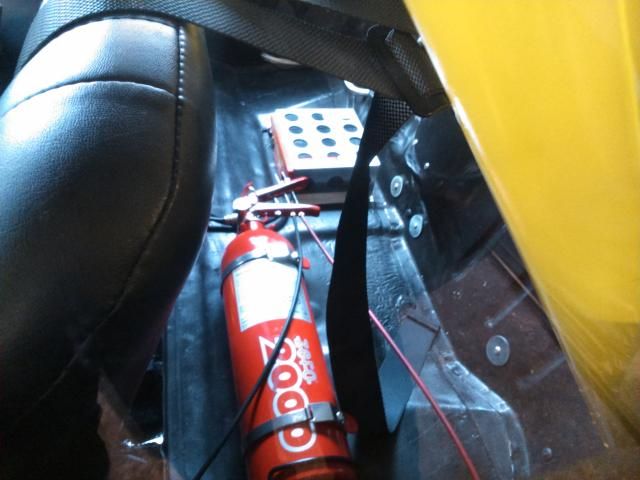

After taking it for a test drive up the road it was awful, rock hard with the competition cones and the engine didnt want to know below 4000rpm, but once it came on song the staright cut gears and induction roar from the weber 45 made up for it. First modification was a mechanical extinguisher system, better safe than sorry

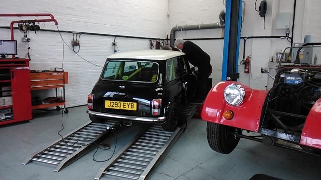

Before the first track day at brands hatch I wanted to make sure the engine was in good health so it had a session on the rollers. The seller had told me the engine was good for 100bhp+ so I was abit disappointed when it made 90.2. It felt good though so off I went to my first track evening.

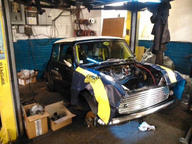

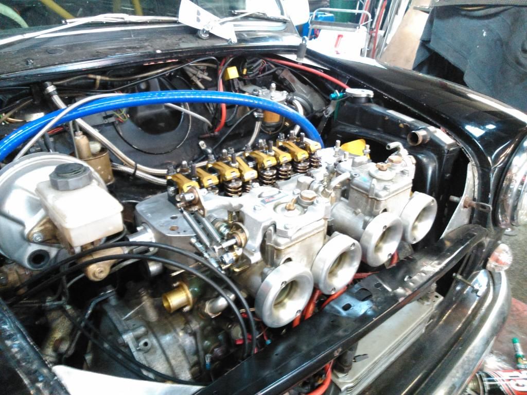

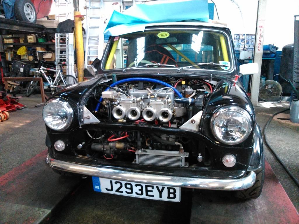

The next track day I booked was the retro cars evening, a week before I was talking to someone about how great twin webbers sound, then  by coincidence a 7 port MED head came up for sale with twin 40s, just my luck. Not sure entirely sure if the MED offset roller rockers were needed but they look nice.
The installation was fairly straightforward, drilling the block for the dry deck would have been easier out the car but do able. This was carried out in a mad rush before the track evening, the day before I just about had it running. The morning of the event I re torqued the head and took it to the rollers. Dreaming of big numbers, expecting 110bhp+ I was gutted when it made 102. You could really feel the difference though, pulled harder. The sound with the windows down at full chat is incredible. With a set of higher compression pistons I think it would make better numbers.

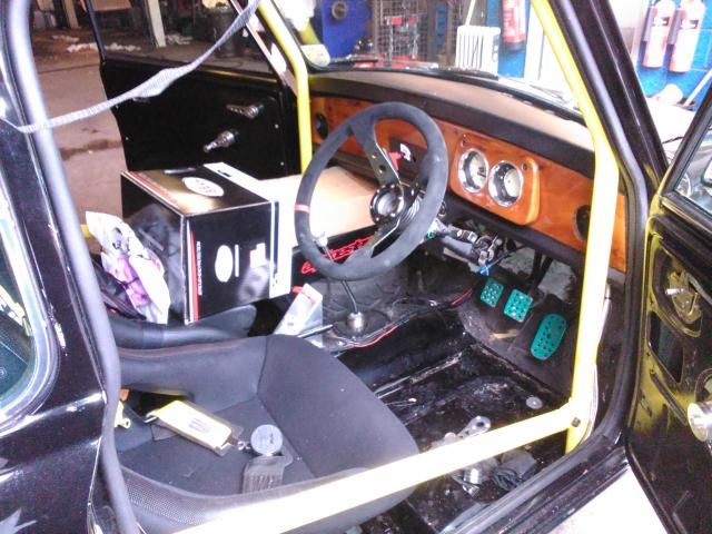

I fancied having a go at sprinting but a few modifications would be required to meet the regs. It was a good idea anyway so spreader plates were put under the rollcage, added door bars, and remounted the drivers seat to msa spec.
