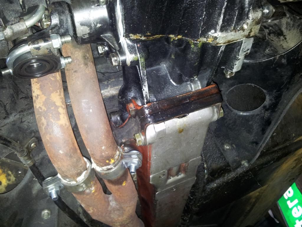

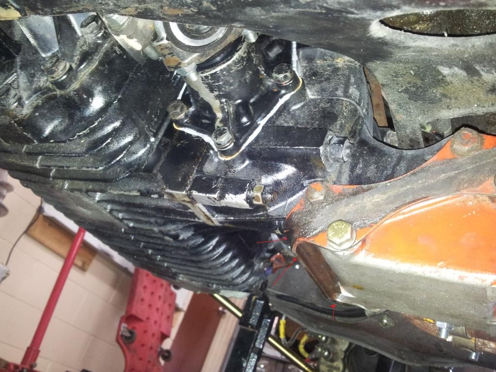

hi all, I have a remote shift mini that I have been attacking a small oil leak with limited successes.
so at first I could see that the diff side seals and housing were leaking , so quick reseal and new gaskets  =  improvement about 80 percent,
next was to pull of the selector assembly and asses as it was still dripping a small amount, so a quick clean down inside and out and reassemble,
and inspections latter its still leaking.
right so I don't know a great deal about the sealing system of the selector  itself so I though it best to ask from experienced mini owners to what I should be looking at in regards to where this particular leak is coming from as the outside housing is all dry now , it appears to be coming from the lower selector housing ? does this need a gasket or is the leak coming from the diff but leaking inside where the selector attaches ?
I am basically trying to assess if I need to pull the engine out to rebuild the diff housing or if there may be a simpler fix that I can do with the engine  in place like a selector seal of some sort ?
here are some pictures, any advice would be greatly appreciated .

Ok, if it's leaking from the remote to gearbox junction, and it's not coming from above then I'm afraid there is only two possibilities...
Oil is leaking up the stud which connects the diff cover to the gearbox, which is inside the diff housing, or you have a cracked diff housing.
I would double check that the oii is actually coming from the housing, and it's not actually transfer from somewhere else..
PS, you gearbox is from an austin america ( ado16 ) not a mini ;)

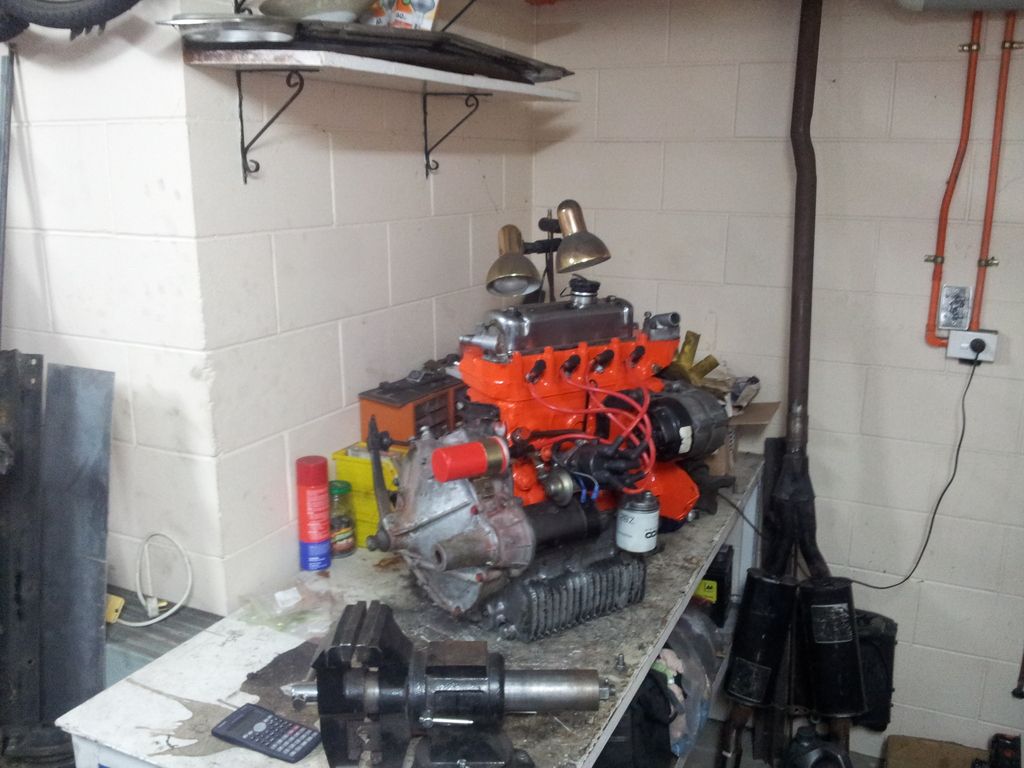

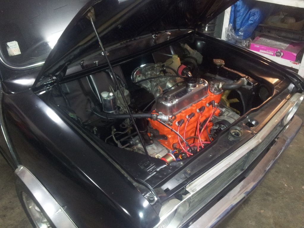

so this all turned out well in the end , I ended up pulling the lump out, stripping it all down. rebuild and re assembled.
turned out the previous owner over shimmed the diff and that was the whole problem. but it turned out to be a good thing cause the amount of orange rtv sealant inside the engine was immense . there was allot of other issues that i managed to catch before trying to daily drive the beast !
i also painted it, this is how it turned out.
