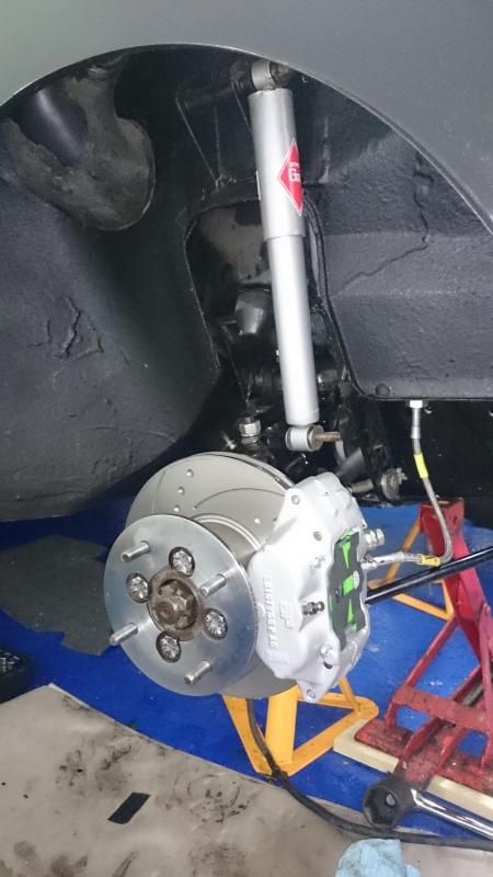

So I've spent a few quid on a few nice bits to get this rolling before Xmas.
The list is.
1. Metro vented 4 pot calipers.
2. Green stuff pads
3. Cross drilled discs
4. New piston and seal set
5. Goodridge braided hose set
6. Superfins
7. Ripspeed Hi lo's
8. Genuine rubber cones
9. KYB gas adjust dampers
10. Genuine knuckles
11. Compomotive tf centre caps
12. Silent coat sound deadening
13. Polybush set.
14. Hif44 carb
15. Oselli torquemaster inlet
16. Oselli rocker cover
I'm now broke!!
#18 ibby4585
ibby4585
  • 391 posts
  • Location: DIDCOT
Posted 15 December 2014 - 08:30 PM
Made a start on the brakes and suspension, pleased with the set up but not looking forward to bleeding them.

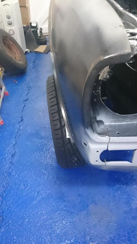

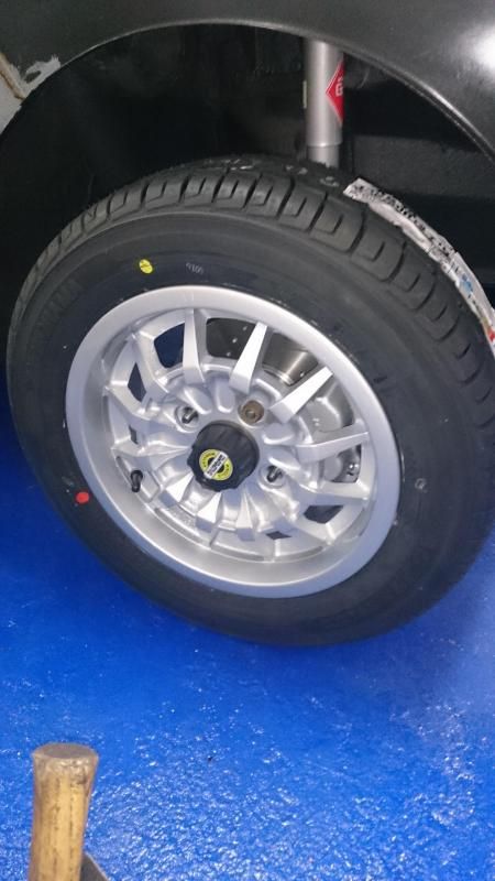

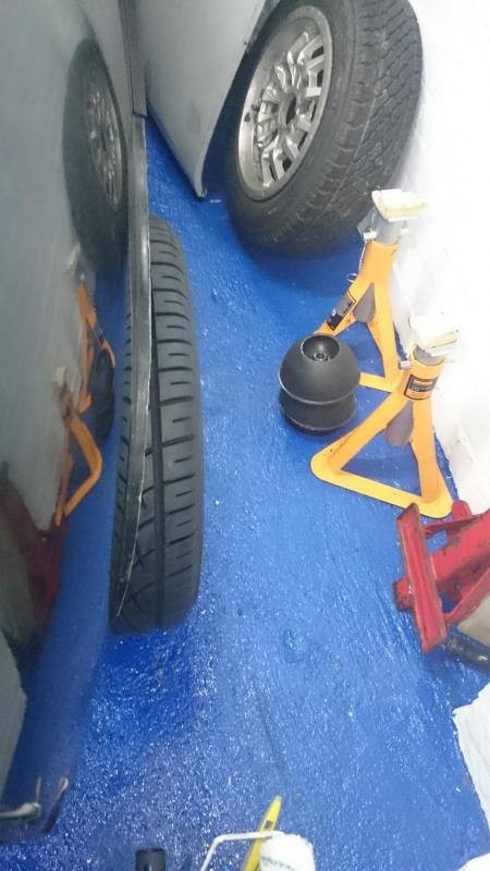

So I've hit my first problem with the Metro brake set up and my Compomotive wheels.
Although I love the look of them they stick out too far to go archless.
I thought the Compomotive tf alloys wouldn't stick out so far, but I'm.guessing using Metro 4 pot calipers it makes them stick out.
Anyone had any problems with this set up? I really don't want arches.
#29 1293gt
1293gt
  • 323 posts
  • Local Club: nonw
Posted 03 February 2015 - 10:01 AM
Yes sir,
 I reckon it's because the discs are vented.
Had the same issue with mine.
#30 ibby4585
ibby4585
  • 391 posts
  • Location: DIDCOT
Posted 03 February 2015 - 10:09 AM
Yes sir,
Yeah im not happy with it, so might bin the Metro brakes,or try and find some nice arches but I dont really like any.
