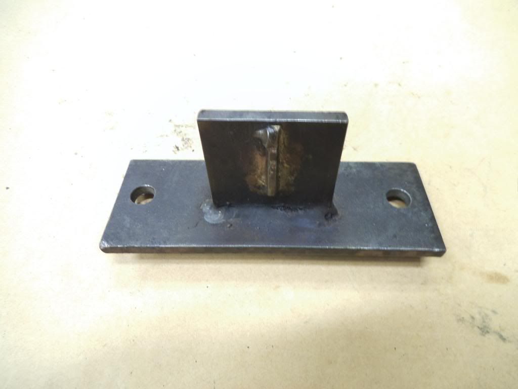

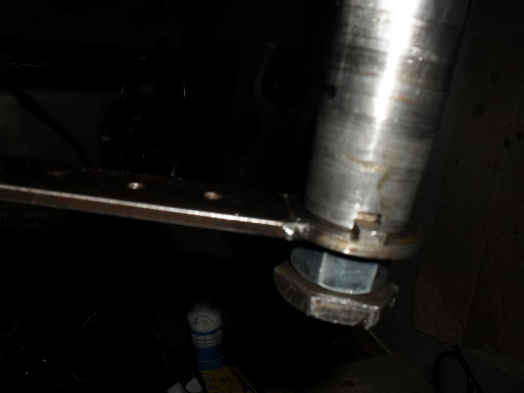

I did make a 'Crank Spanner' a while back, one of the handiest tools I have when stripping or building engines

I have a similar home made tool - great for when setting cam timing with DTIs

I like that crank spanner - I've never seen one before and may have to copy that myself. I always remember to leave the flywheel on as I made the tool that bolts into the starter motor bolt holes that locks against the starter ring teeth.
Great stuff, yes, I made one of them too;-
You know, you get by for years without these little gems and once you've used them once, you'd never be without them!

One more vote for the piece of wood.  However, (and I don't make it a habit to say this to guys), Spider... nice tool.  I like the concept and will make one the next time I have an engine out for rebuild.
