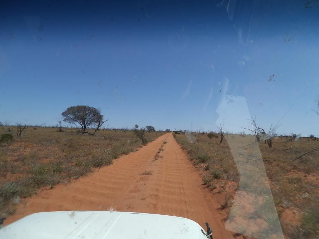

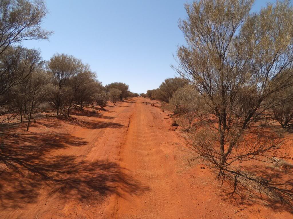

Yes, Dan and Cooperman are correct in saying that a Mini doesn't need a steering damper.
I looked in to it because this is the type of road that I frequent;-
I can very much assure you that after some 1300 km of that, you'd really like a steering damper!  O_O
