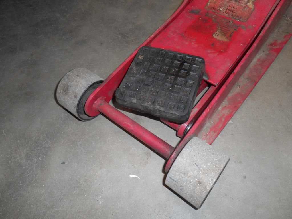

 and use a little square pad  :D
Some brands of Jacks have available a Rubber Pad to take the place of the Steel bitey thingy they all come with, that's what I have, perfect on a Mini, maybe not so on other cars.
I also fitted some rubber faced machinery mounts to the tops of my axle stands, once again, perfect for a Mini.
If I remember later, I'll throw up some photos.

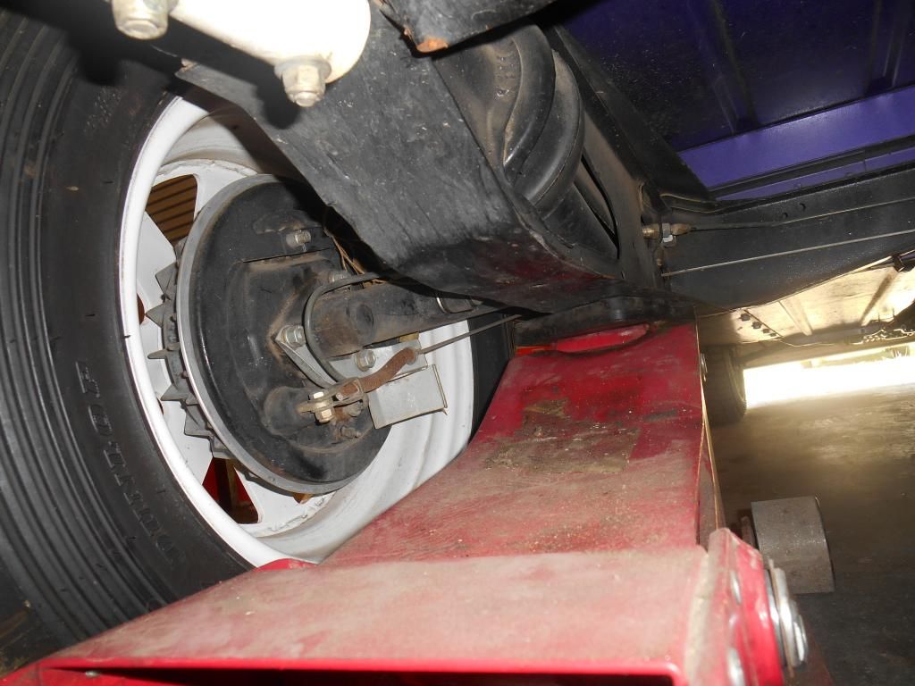

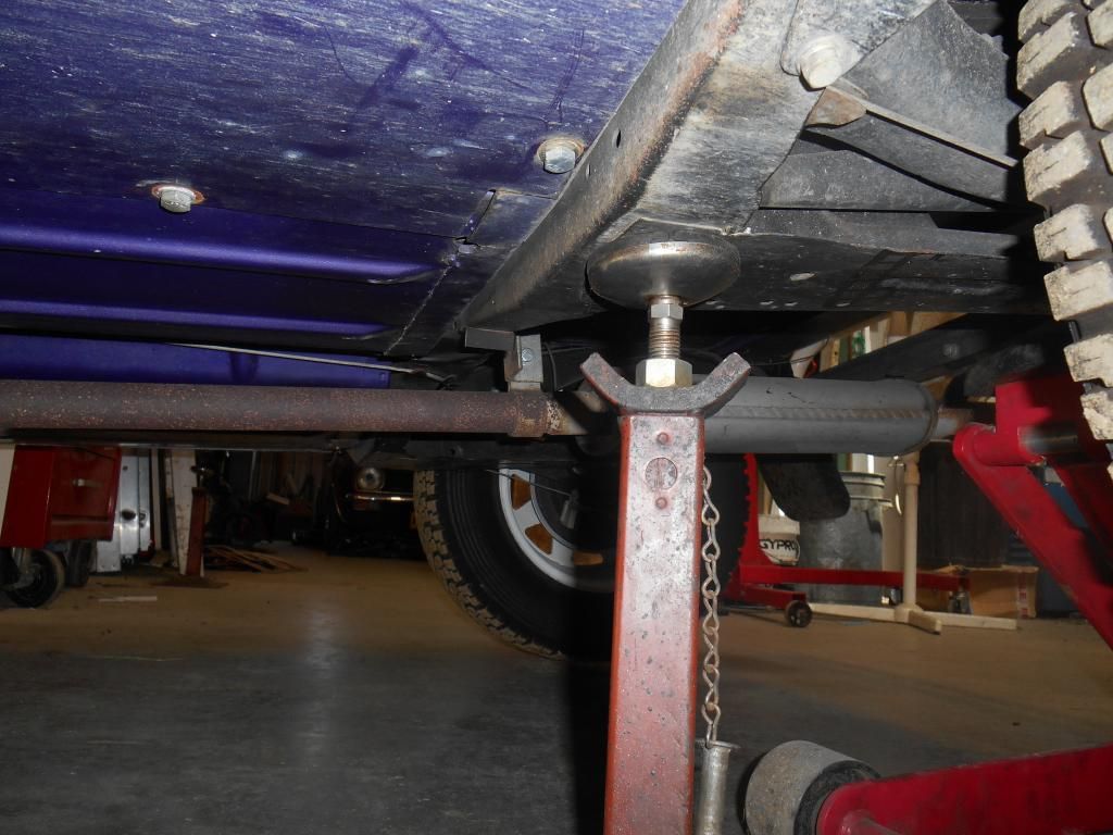

I did manage to snap a few off today - pics that is,
Jack;-
Stand;-
