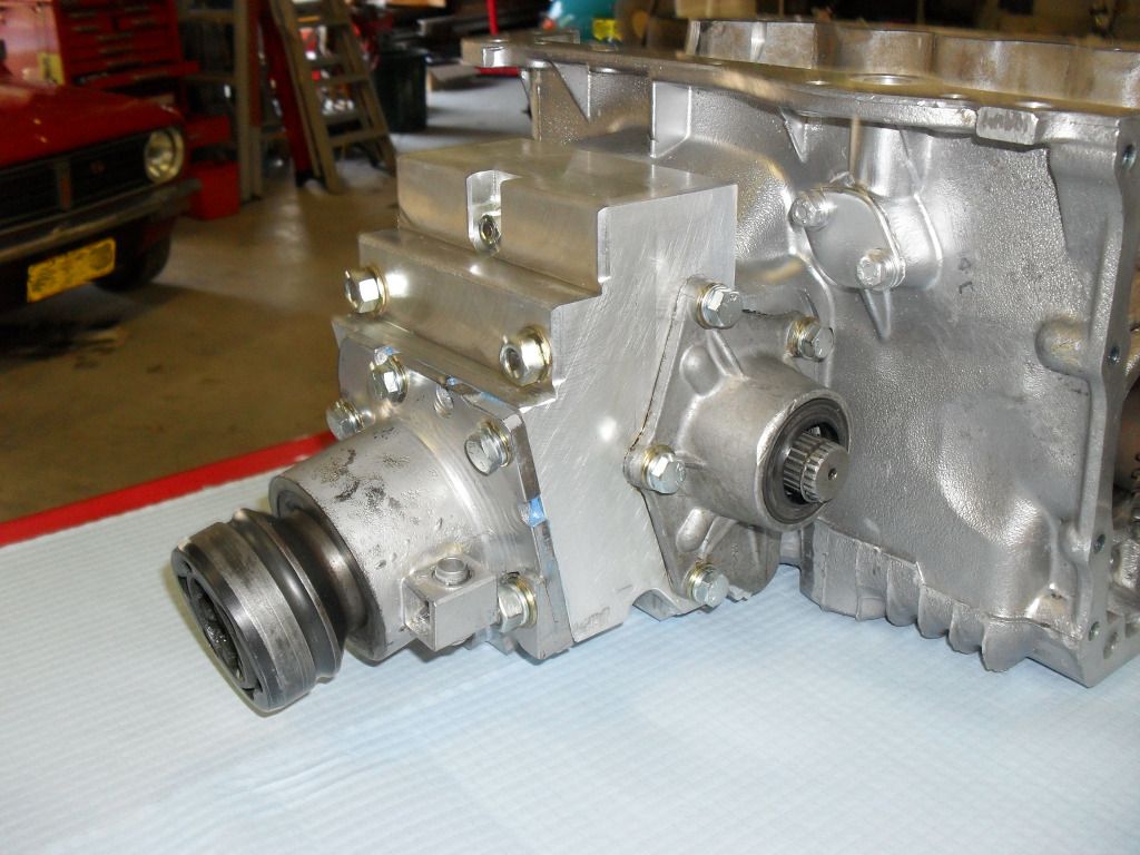

3e2c9f91070c7bdbfd764ccb30252e46ba7f87c8
Only seen this thread for the first time today - blown away by the engineering you did on this Spider!
Just looking at the above picture, the output flange from the diff looks as if it is pointing downwards at quite an angle? I take it thats just a UJ that then takes the drive rearwards, will that not cause problems eventually running at that angle - or maybe its just deceiving in the photo?

The output here is actually a Drum Brake CV Joint - not what you'd be expecting ! This couples up to a stock long drive shaft which has a Pot Joint on it. This provides a sliding coupling to the rear diff to allow for normal movement between them. The use of the Driveshaft up front here gives clearance to the shifter as it's all rather cosy up there !
