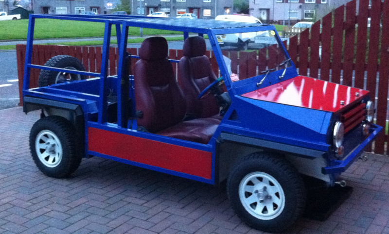

Having fitted a 1275 into a Scamp, Having problems clearing the Bulkhead with an HIF44, is there an adjustable engine steady I can use  tilt the engine away from the bulkhead or do I have to make one up?

Got any pictures of you Scamp ?
