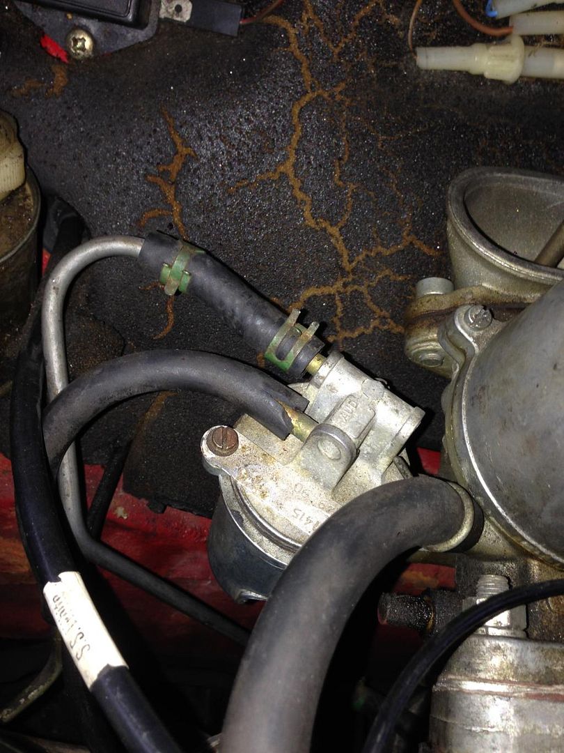

Went for a drive today, and at random points the engine started stuttering, usually when my foots on the accelerator, sometimes only slightly pressed and even foot to the floor. Then when I lift off, or pushed the accelerator harder it went away.
Any clue to what's up with it? I'm thinking it will be something to do with the fuel/carb? I took the airbox off and the cylindrical thing to the left of the carb had one pipe end split, with no clamp. Is this correct?
65396AD2-9318-44CD-8B84-FA48DBB12058_zps

The split pipe is an overflow to take any petrol spillage from the carb safely away from the exhaust.  Cut off the split end and refit it.  No clamp is required. This is a potential safety issue but should not affect running.
