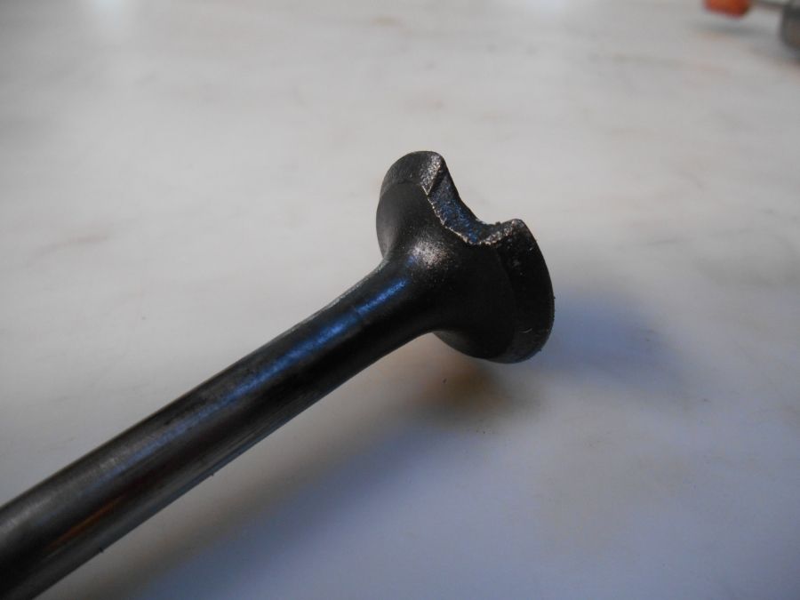

This is an Exhaust Valve I pulled from the head of an 1100 engine about a year ago
24f3a31f-7edc-40f8-ad6a-d505cc232f21_zps
It kinda looks like it's been oxy cut.  It also cracked the head.
The owner is a reasonably sedate driver in that while he would keep up with surrounding traffic, he wasn't one for ringing each and every gear out either.
The distributor fitted was for a 998 engine.
When the Advance Curve of what should be fitted is compared to what was fitted, the reason for the badly burnt valve starts to become clearer

The RPMs and Degrees Advanced in that Graph ^ are at the distributor, so you need to multiply them by 2 for what's going on at the crank.
Looking at the graph, what is clear is that right around 'the normal cruising zone' from 2000  to about 4000 RPMs, the required Ignition timing was quite retarded. Driving with it in this state causes very hot gases to go through the exhaust as the fuel is still burning (or not long finished) as the exhaust valve starts to open, causing the burning of the valve. If it were from a lean mixture, then the valve would have a white appearance.
Note too that this particular distributor, as fitted, doesn't have a Vacuum Advance either, which in this case, could have helped.
This shows why the correct advance curve is important and just one example of serious engine damage.
