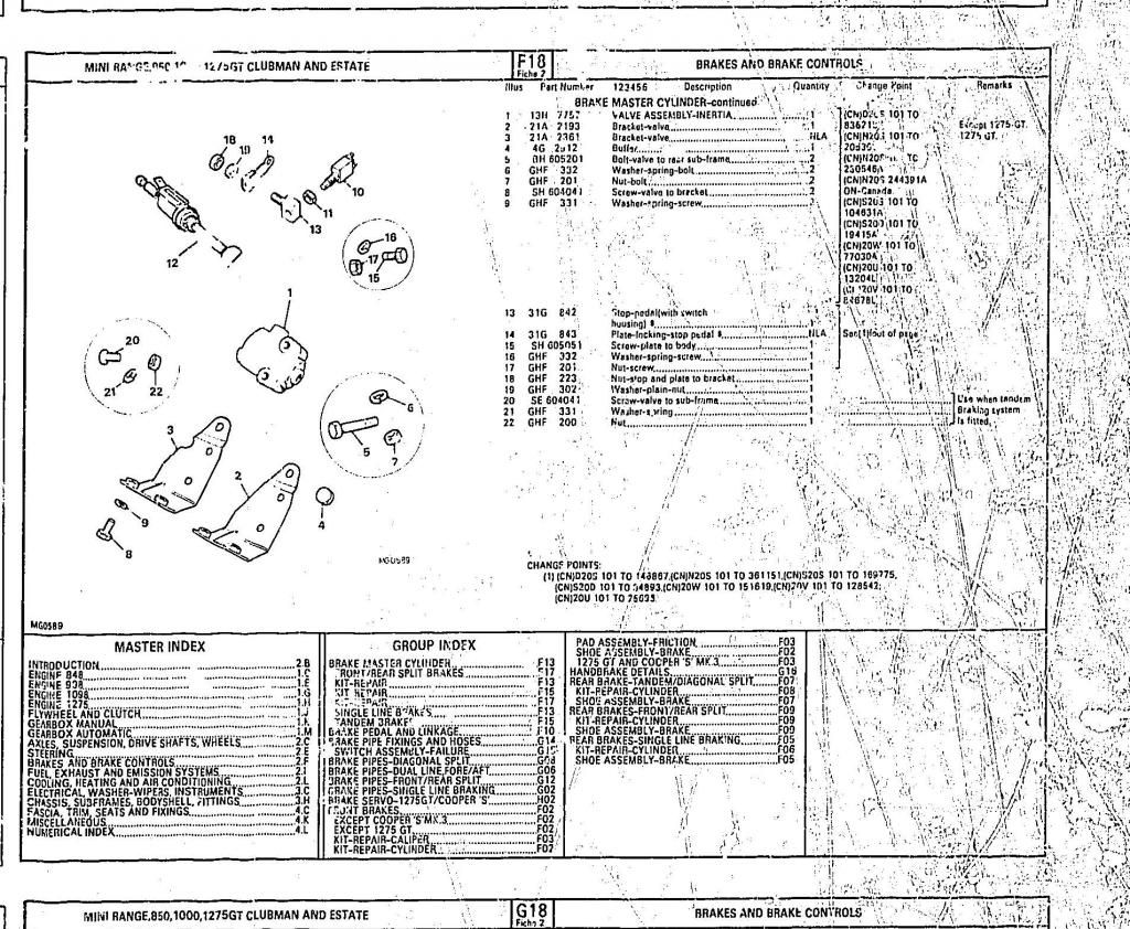

As I mentioned on the other forum, they didn't have the pressure limiting valve, they had an Interia Valve, P/N 13H7757. They are very hard to come by, however I saw that Mini Seven in the US still have a few.

They started fitting the 13H7757's in 1978.

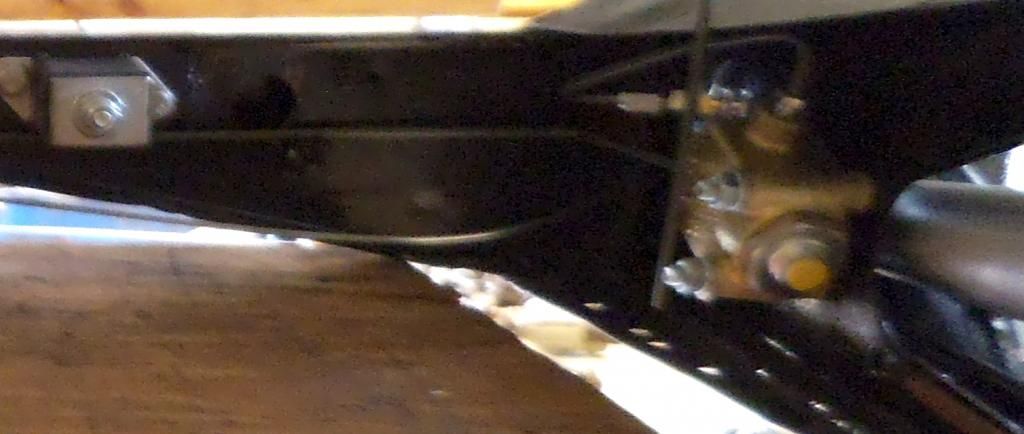

#7 Spider
Spider
  • 15,136 posts
  • Location: NSW
Posted 04 January 2015 - 09:07 AM

That page from the parts book ^ is for UK cars (sold in the UK).

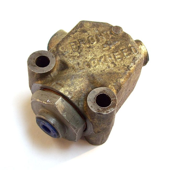

There is this.
Basically what your describing, but I must admit I'm not sure any of my mini's had it??

Err, no.   That is a Pressure Limiting Valve, however it is not a standard one in any case, it is an adjustable one.
This is a 13H7757
and this is where they go (sorry for the poor pic)
I don't know why Mini Spares don't have them, they are hard to come by, however BullMotif in the UK have them as does Mini Seven in the US.
They were only fitted for less than 2 years in production, and at that time, not many GTs were made.
