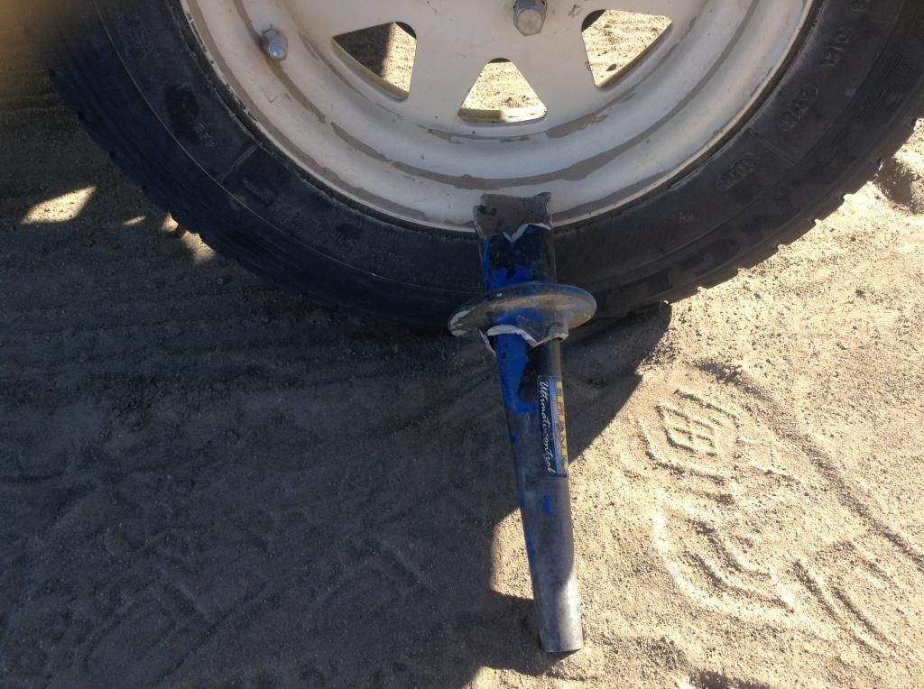

Here's a picture of one of the 4 gussets I added to an old frame of mine. It's an awful picture but I believe the gussets position is the same as a Sportspack frame.
Cheers Tupers. Gotya now.
We do something similar, though not as elegant
We do it so we don't break trumpets, like what happened to one of our travelling companions on a recent trip
the brace helps stop the rubber cone along with the trumpet from trying to tip sideways (effectively bending) on heavy compression. Well, that's why we do it (and that's wht the owner of this car ^ also did it on his return).
