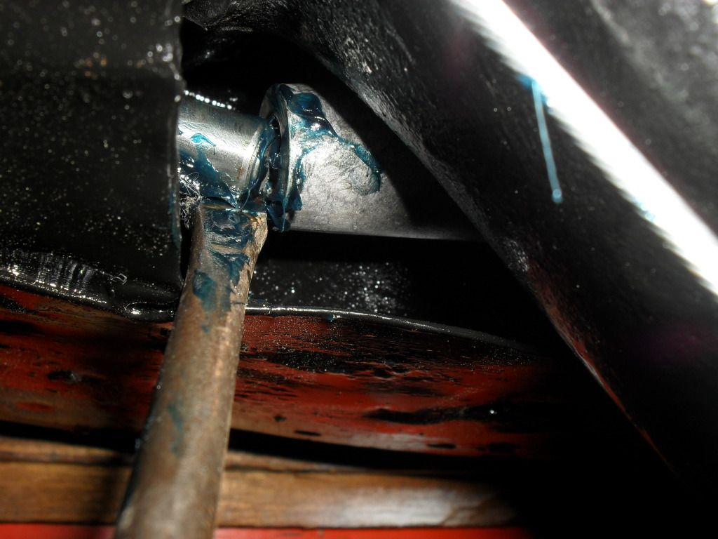

Years ago, I found they went together more or less as per the Manuals, sometimes with a bit of tougue wiggling (as they were a 'neat' fit), but they did go in. Then I found the rubbers cones seemed to have grown a tad, then I found they could be slipped together at the knuckle, hard to describe, but sorta line up the little end of the knuckle and the trumpet so they are ready to go together, but there'll be a bit of a 'kink' between them, then carefully lever the small end of the trumpet up, so they start lining up then they'll slip together, this pic may help
I have also had a few where I've had to use the compressor tool, in a mini, that does mean dropping the rear of the subframe down, not a biggy really (4 bolts and maybe the exhaust if it's on) just another step.
