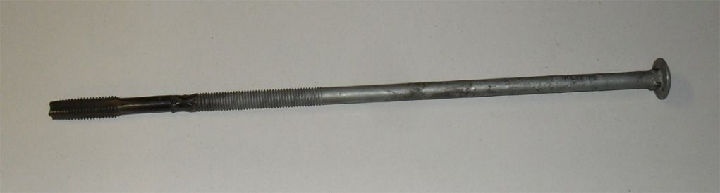

Sometimes the threads need cleaning up and there are others that the steel plate seems bent, so the thread in the nut's no longer square enough to get the tool in. I have an extra long M14 Tap that I made up for cleaning and / or correcting the threads
I use that Tap, every time (even on NEW cones) without fail to save the compressor tool.
