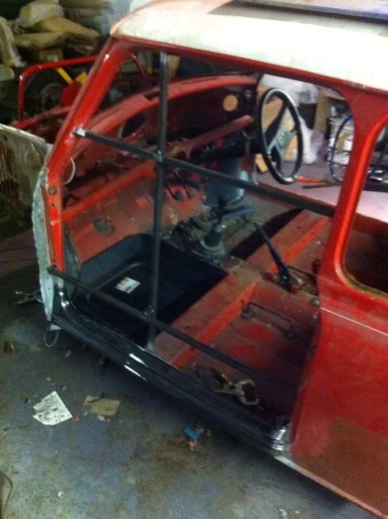

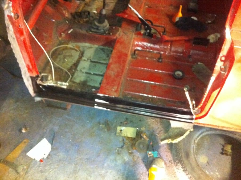

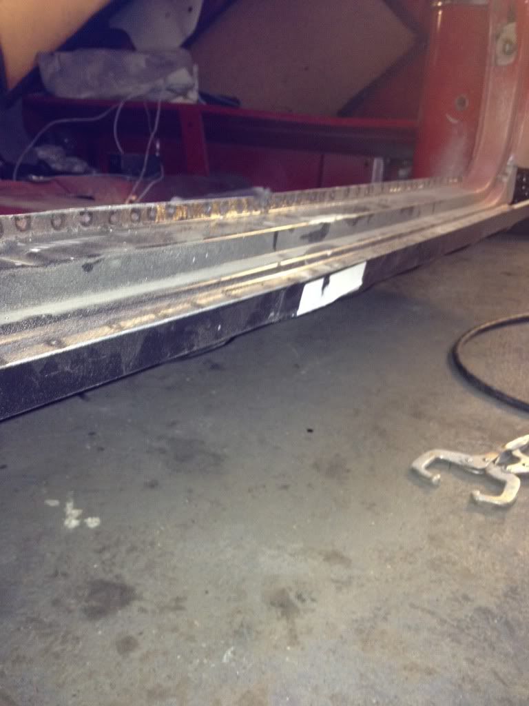

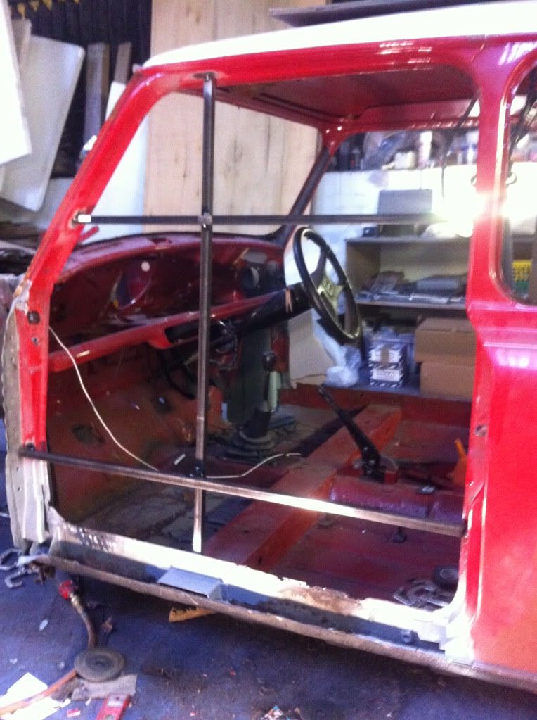

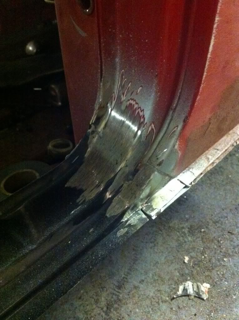

Here's the only pics I took when I did mine
Use a heritage panel as the non genuines ones just do not fit as the folds are not in the correct place
