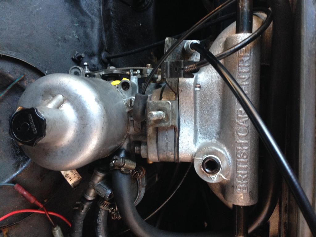

As above, I take it you've fitted an aftermarket manifold & inlet too, as a change of exhaust on it's own really shouldn't alter the position of the carb. If so, you could try a different inlet as the design of them does vary slightly. I've got the minispares version on one of my minis and that leaves plenty of room for a standard air filter box/housing. On my other mini I've got the MG metro inlet though and that leaves much less clearance between the carb and the scuttle, none of the mini air filter boxes will fit, but you can just get an MG metro housing in there with a bit of purisuasion, as it's not quite as deep. You have to cut the inlet duct off though as it feeds from the passenger side of the engine bay in the MG metro item, as opposed to the drivers side.

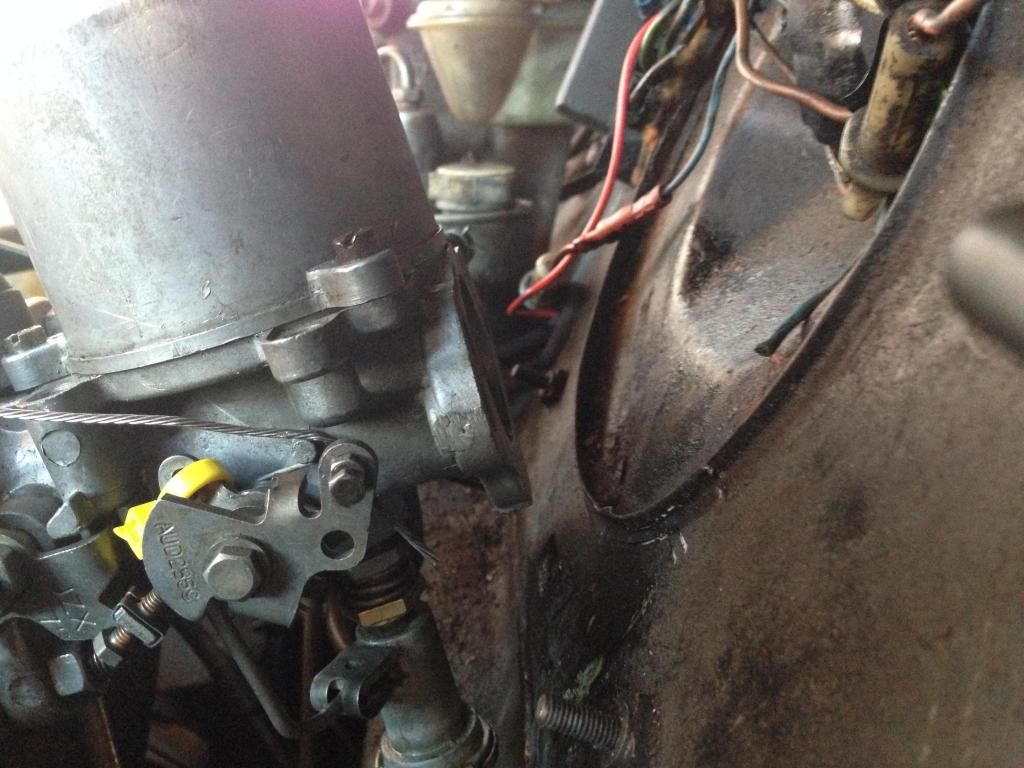

Posted 09 February 2015 - 04:01 PM
here is what I'm currently working with. original spacer and a British car centre manifold
#8 ukcooper
ukcooper
  • 1,625 posts
  • Location: Stoke on Trent
Posted 09 February 2015 - 04:42 PM
Buy one of these then adjust it so your engine comes away from the bulk head..

#10 wile e coyote
wile e coyote
  • 1,230 posts
  • Location: North Somerset
Posted 09 February 2015 - 10:05 PM
you could shove the engine forward with an adjustable bar - but..... that'll put the engine mounts and existing tie bars under additional stress - .reducing their effectiveness / life (and possibly increasing transmitted engine noise) . better option is to get a manifold that fits properly.....the mg metro one already mentioned is great and can still be had on fleabay...
#11 KernowCooper
KernowCooper
    Sparkie
  • Mini Docs
  • 7,847 posts
  • Name: Dave
  • Location: The South West
Posted 10 February 2015 - 12:49 AM
Is yours a 998 or 1275? the block height is 3/8" taller on a 1275 so lifts the jet by that amount and away from the bulkhead
