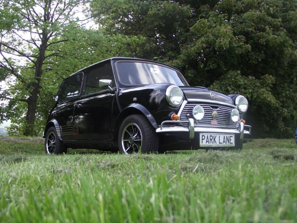

My minis currently sitting on 5x12 d1 dunlops with wood and pickett arches not to sure whether mine are 2.25 or 2.50 as i bought them a few years back at bingley (on the cheap as they needed refibreglassing)
Couple of photos should hopefully help you out a bit (my wheels stick out of the arches slightly but nothing major :D
Hope this helps a little :D
Dam those are nice :) Suits it perfectly think i will definatly need 2.5 to fit my 6" wheels. thanks!
