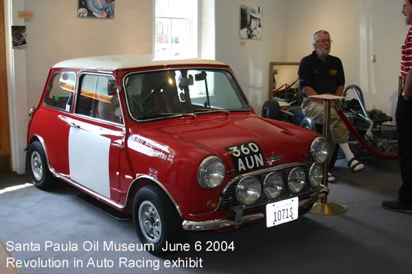

On the Mk.1 Cooper & Cooper 'S' the remote gear shift housing has a tapped hole near the front of it at the top of the housing going down at about a 45 degree angle.
There should be a clamp bracket which attaches this to the remote housing with a 5/16" UNC bolt (I think it's 5/16").
It is very different from the other types of Mini as the Cooper/S gearshift is unique to those cars.
Raining in San Diego? It is one of my favourite places and I envy you living there. My friend in LA has a beautifully prepared 1963 Cooper 'S' 1071 rally car (for sale if you know anyone who might be interested).
