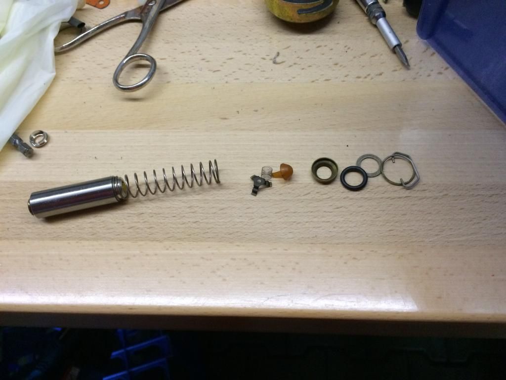

#3 nicklouse
nicklouse
  • 18,688 posts
  • Location: Not Yorkshire
Posted 27 March 2015 - 10:00 PM
The internals of my old one.
6E903421-2B5D-4E54-AC5D-AA7031644123_zps
