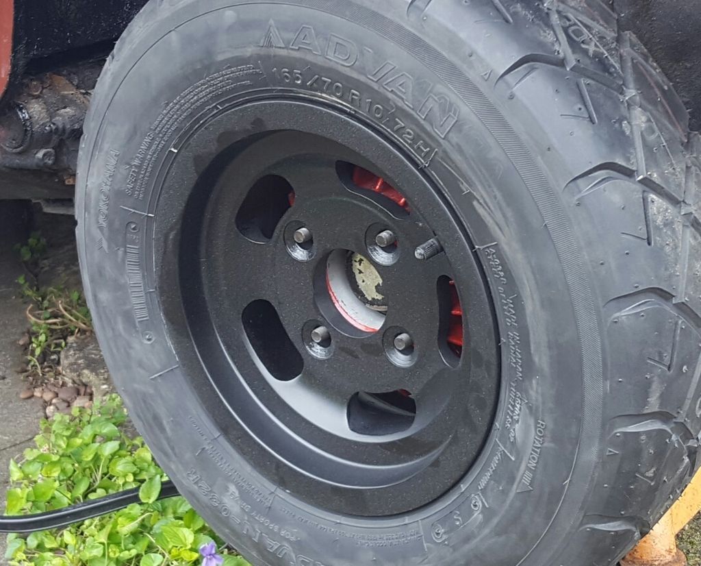

A bit of a thread bump but I've had the refurbed and got my yoko's on them. I'm struggling to find wheel nuts for them. It would appear, as the hole the wheel stud goes through is pretty big that I'm going to need sleeved wheel nuts. Am I right in thinking this? The wheels have a radius seat so would I need to fit a specific washer under flat sleeved bolt heat?

Cheers for the help mate. As you can see from my photo (I know wheel is on the wrong side) your wheel nut seat is flat but mine is radius.
So I don't think I can use the flat washer like you've got.

It would appear after a chat with an ebay seller and a closer inspection that my alloys would have originally had a flat seat. However they seem to have been used with the incorrect wheel nuts (radius type), causing them to change shape. Some holes are just starting to form a tear drop shape on the seat.
