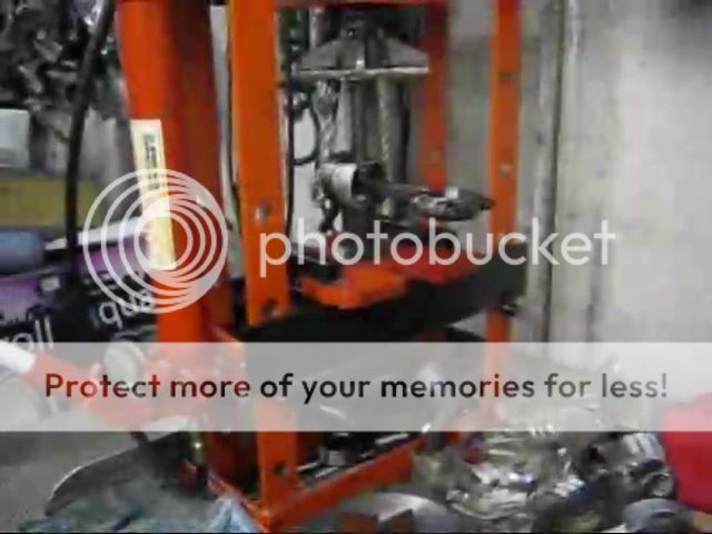

http://vidmg.photobu...stonfitting.mp4
Push out cold. Only heat the rod to refit the pin. Only heat to straw colour. Practice first, and you need a press and a proper jig to hold the piston or you will damage it. Use 1000grit paper to clean the rod bores, and measure the internal size at room temp to ensure you have at least 0.0008" interference fit before you assemble. If you can't do this measuring leave it to a professional.
Only do this if you can make the proper tooling.
