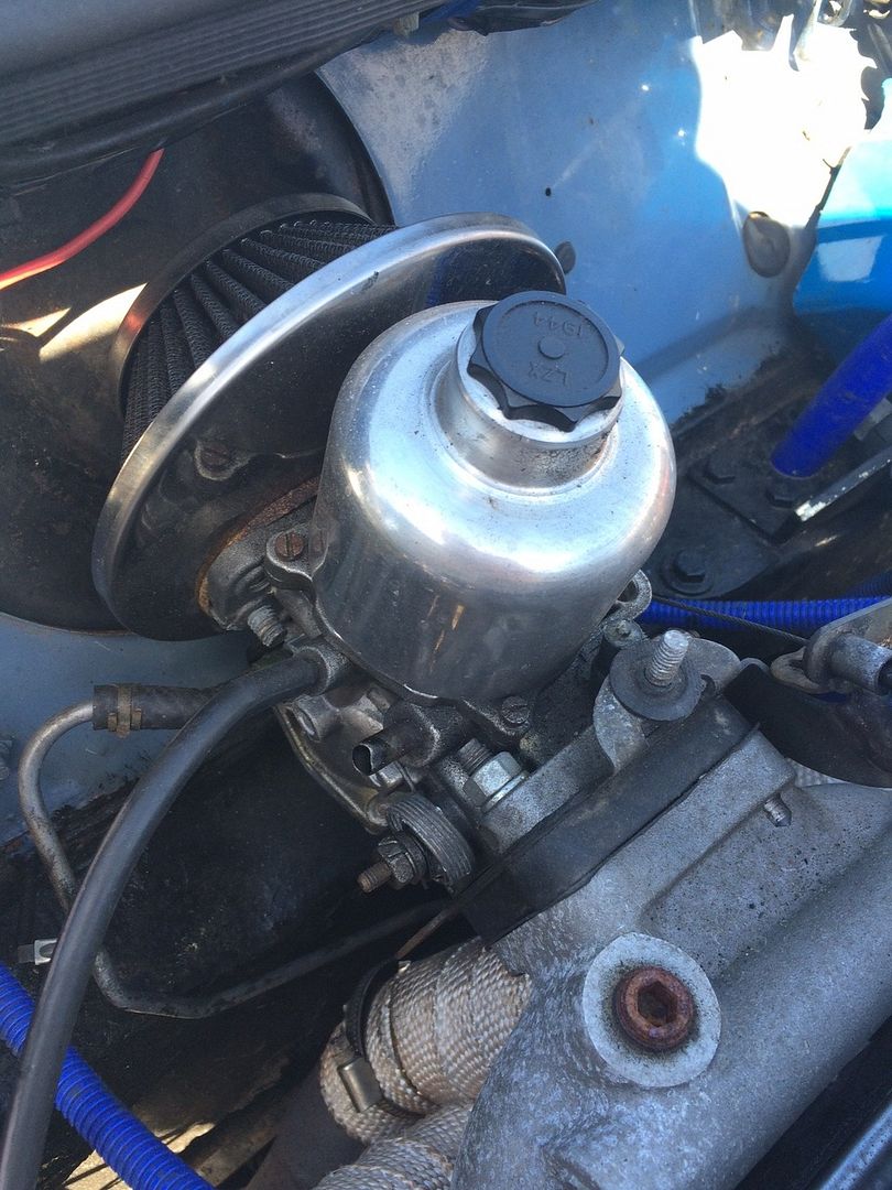

#8 T10NY
T10NY
    Just On Tickover
  • 8 posts
  • Location: Aberdeen
  • Local Club: AMOC
Posted 11 April 2015 - 07:22 PM
picture attached.
#9 Leonrjohnson
Leonrjohnson
  • 166 posts
  • Location: Cairns,Queensland
  • Local Club: MOCQ Far North
Posted 11 April 2015 - 09:06 PM
The big pipe connection that you show in the pic (that is open and has a slight kink) is for the crankcase breather, so if you aren't using it, you need to blank it off, as it sucks air and runs LEAN. Also the vacuum advance hose connection port on the carb needs to be blanked off. It is showing in the pic as having something on it, but needs to be blanked off. It is the port on the base of the carb close to the unused stud for the air filter that isnt being used.
picture attached.
#10 T10NY
T10NY
    Just On Tickover
  • 8 posts
  • Local Club: AMOC
Posted 20 April 2015 - 07:05 AM
Hey guys so the vac advance on the carb being missing was indeed one of the problems. I have got te running ok, it's running 12 deg advance at 1300 rpm and idling ok at 1050 rpm. However it's really sluggish and lacks power. Should I continue to advance it to see if that helps any? How far should I go? I have also replaced the plugs as the old ones were a bit worn.
