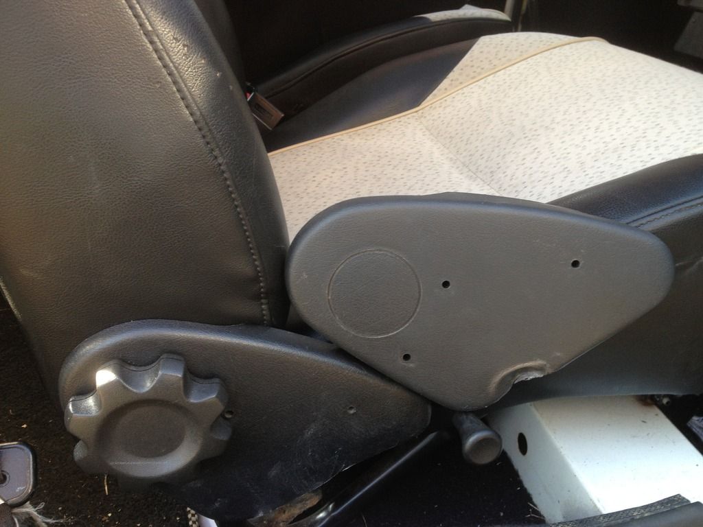

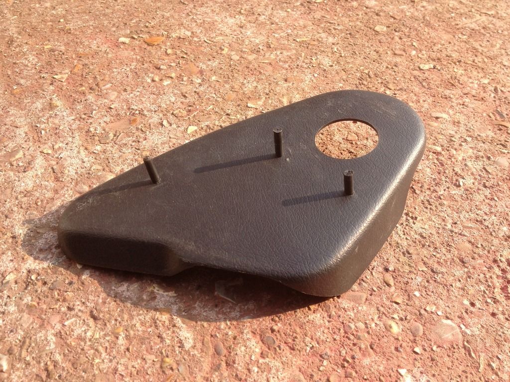

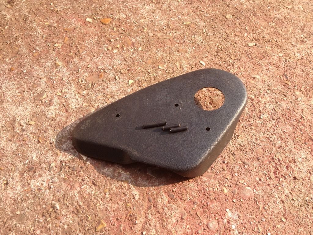

Posted 09 April 2015 - 08:01 PM
Here ya go....
There's three plastic pins in each cover & one is longer than the other two, so make sure you remember which way round they go for refitting. I'm not aware of a special tool, (that's not to say there isn't one), but just used with a small centre punch, and I even made do with an appropriately sized nail with the end blunted off once.
I can't recall exactly how I tapped the pins out now, not sure if I I tapped them through from the front, although I've got a feeling that I may have taken the seat out of the car, turned it upside down and then tapped them out from the back, and got at the uppermost one by folding the seatback forward.
Aside from Somerford I'm not sure of anywhere else that sells them, Mpi seat spares seem to be a bit difficult to come by. When I was trying to source a new mpi seat frame, in the end me and another TMF member in the same predicament had to go halves on a full set of seats and then strip them down for parts, which is how I ended up with these left over. I assume they're no good to you though, as they're the wrong colour?

Posted 20 April 2015 - 07:41 PM
Sorry for the delay on this, but I finally got around to taking another look at this today. Yes it would seem that the spare covers I have are the same colour as those on my mpi Monaco seats (see pic below) as you can see though the R/H drivers side civet I have isn't in brilliant condition though as it has a stress mark at the bottom.
Now just to confuse matters you might have noticed from the photo that I actually have the l/h cover on the r/h side of my drivers seat, and that I also have the adjuster mechanism on the r/h side of the seat as opposed to the left. This is because I've swapped the seat backs over, as they're interchangeable.
