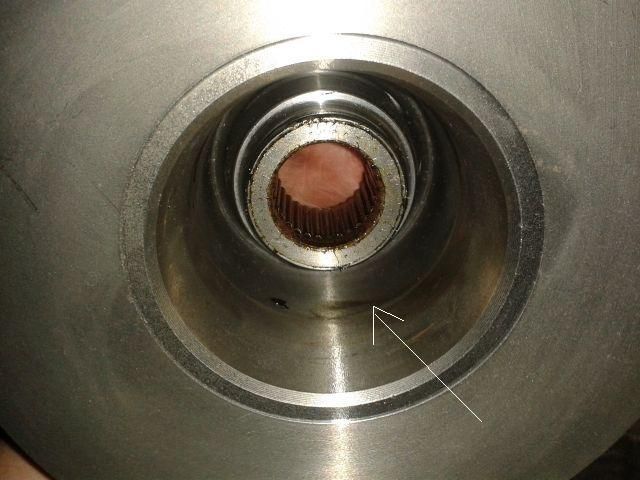

Wondering if anyone else had come across this issue. 92 Cooper Spi, so 8.4" disc setup as standard. I bought the minispares own brand 10" conversion kit, and started fitting it tonight. Didn't go well.
The problem is that the disc fouls on the hub. The outer part of the hub containing the bearings, fouls on the inside of the disc, the 'top hat' part. In pictures, this part :
Fouls on this part :
It's pretty bad, you can barely turn the disc at all as it just about binds. I tried fully seating the bearings using the correct flat washer and torqued it up, just made it worse.

nicklouse, yes the flange is fully seated. I read those threads, seems it's not a new problem, however as you can see from my pics the step is already there, and it's not the nose that seems to be fouling, rather the larger part of the hub. I have PM'ed Simon@minispares so i will see what he thinks.
Can I safely remove material from the larger diameter part of the hub?

The step is already there but its there on my hubs to, its just different to the step on older hubs.
Mine binded exactly the same as yours, in the same way. Even just by filing off all the rust etc you'll find the discs free up a little!
It is safe to remove material from there, because you'll probably find you won't have to remove much at all.

Thanks rawlins. Going to pick up a set of digital calipers at Maplin on the way home today so I can check exactly where it's catching, then I will just need to set about it!

Those discs would fit an early upright. So as made to spec 7.5 disc they are fine. However given the later spec change of the upright they catch. Not really an issue. You either need matched bits or to clearance the upright

The OP did as soon as he posted the thread. The issue is not the disc, it is the hub. For same reason across a certain timeframe (details I don't have) someone at Rover or their supplier at the time decided the extra clearance wasn't required on the later discs. When they realised it then wouldn't fit earlier cars with a smaller disc, it was then re-instated.
