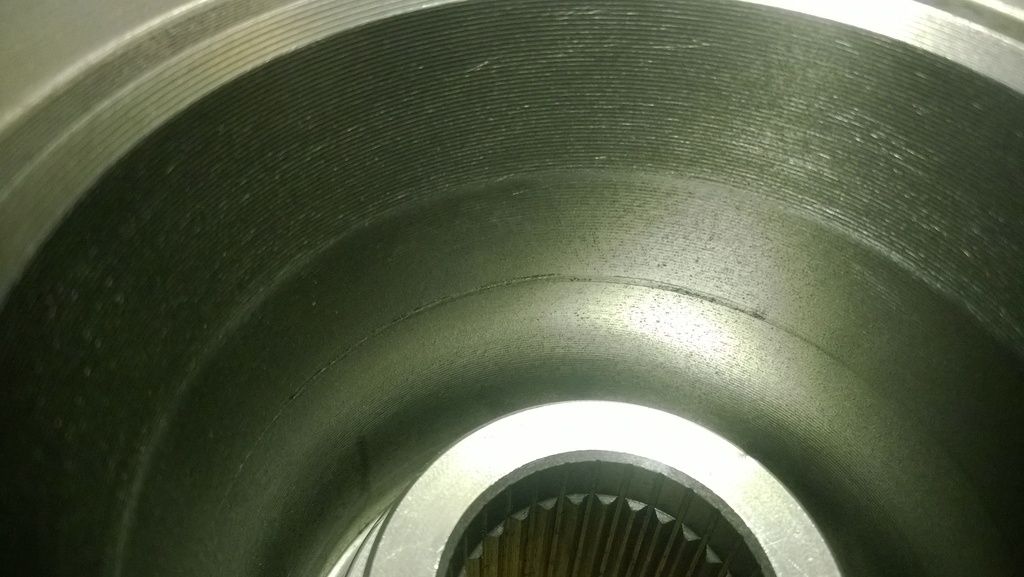

I got it sorted in the end, I did indeed need to fettle the hub a little with a grinder and a flap disc. It was just after the increase in diameter from the lip up to the main thicker part. Didn't need to remove much, and in fact the driver side was only a tiny catch, whereas the passenger side was a bit worse. Not the nicest feeling attacking hubs with a grinder, but it should be OK as the casting is very thick there and it was only about a 2mm broad section I had to relieve about 05-1mm.

Just reading this for the first time after being linked to from the same issue happening now.
I see the issues, I can't understand why they don't just machine the inside of the discs to the profile of a standard disc, instead of the curved profile. It will then fit both upright styles.
