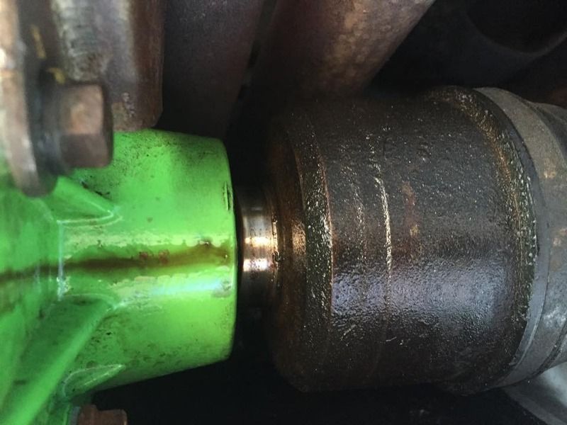

Posted 24 April 2015 - 05:20 PM
this is what I mean- It was out further than this
11160116_10206696322713347_171143977_n_z
Edited by v8rumbler, 24 April 2015 - 05:21 PM.

Maybe someone has left the circlip off the end of the output shaft or the pot joint was not fully slid onto the output shaft (circlip not fully engaged).
Have you tried manually sliding the pot joint towards the diff case to see if it will click on the circlip?
If there's no circlip there then the oil needs draining and the pot joint slid off the output shaft to see if the circlip is missing. If so then source the appropriate circlip and fit.
Should be part number 22G2688
http://bullmotifmini...shaft_pot_joint

Thanks for the photo, now we know were to look!
As whistler has said.
Also, I came across one that did this and it was the Oil Seal. I can't recall if it wasn't seated properly or if it was the wrong seal, put it sat just too proud and so wouldn't allow the Pot Joint to go fully home for the C clip to lock.
