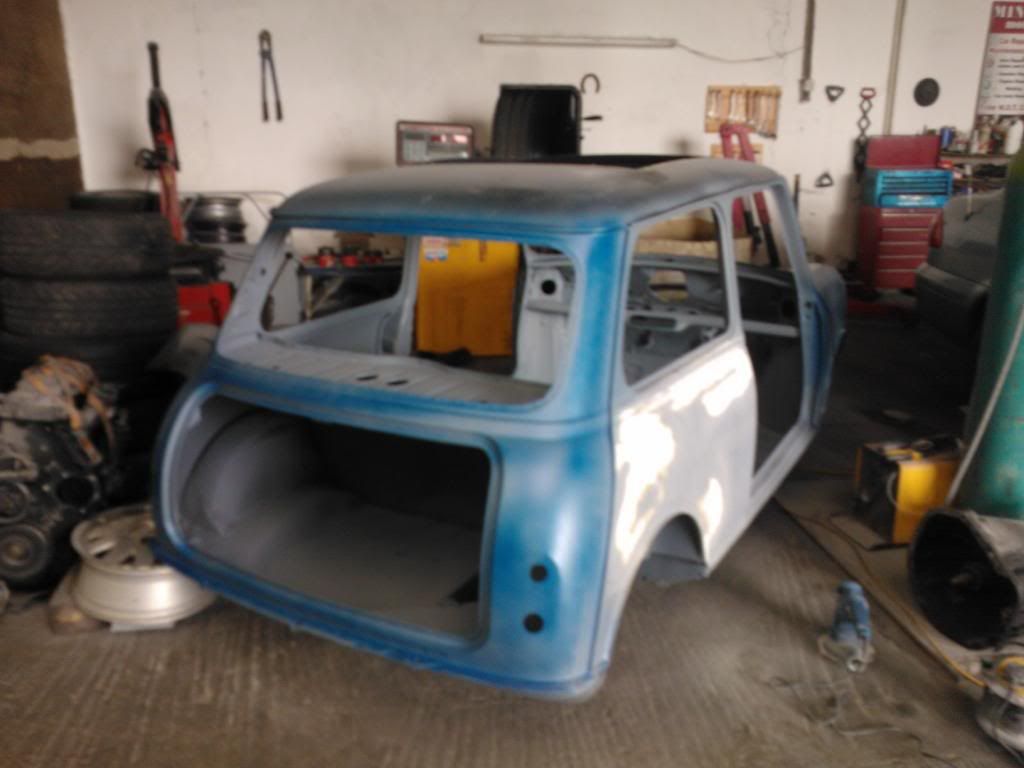

thanks finch661,
do you have a photo with them fitted?
Chris
its a crap pic but
