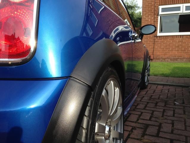

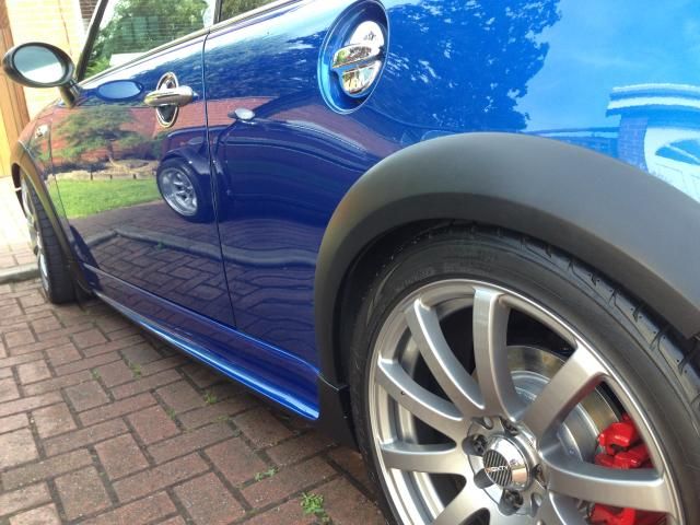

Machine polish and then use Collinite Wax one of the best waxes, all in one polish and wax is ok for a quick finish, here is a mates Golf i did with it,and my Seat. The Seat took 3 days to get the whole car done, I'm very careful where I park it
They look great. I think mine is pretty good now, but I'd like more.
