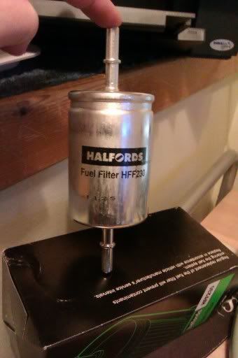

Anyone know which type can be used instead using  push fit connectors instead of threaded ones ie part numbers etc,would be a useful mod which will makie changing filters a lot easier,something im planning on doing if i decide to drop my frame later in the year.

I'll have a look for an old post of mine (might be on minifinity) as I had listed the halfords part number in it...
Edit: found a pic in my photobucket:
Looks like HFF230 to me
Also found this post from someone else which suggests HFF204 :
http://www.theminifo...t-the-adapters/
I'll check on the off the road mini in the garage to confirm my HFF230 is what is fitted currently. I seem to remember running one of the rubber hose runs that you end up with when you 'convert', under the filter so it is held in the bracket basically, to keep it out the way of the exhaust.
Can't remember if maybe I swapped the filter round in terms of In and Out too, I just did whatever gave me the neatest routing for the rubber pipes. Other than that I just cut the pipes - didn't bother flaring them or anything, but I did use two jubilee clips on each pipe as an extra safety (as there is no flare on the cut pipes, so it avoids the risk of one of the clips failing - not likely that two will fail)
