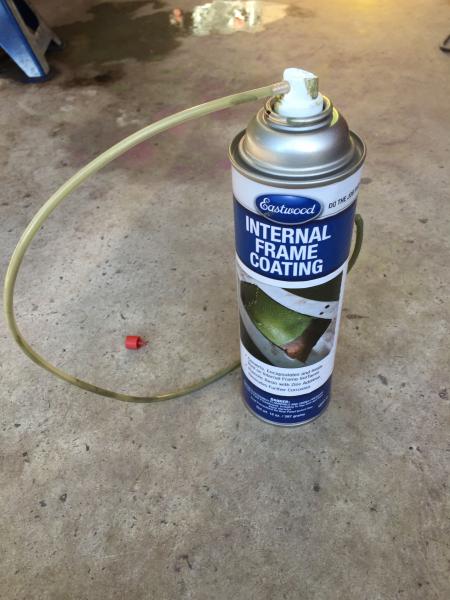

When I come to mine I will paint them (zinc, etch prime and top coat) before welding then after welding I'm going to follow up with this which I've currently used in my A posts, can't be sure of it's true long term performance but it certainly does a good job of thoroughly coating everywhere and seeps nicely into all the spaces and cavities and oozes out through the seams between welds where they aren't extremely tight together. I'm hoping this will add some protection long term as it's not cheap at £19 a tin....
It looks like this when it goes on...
