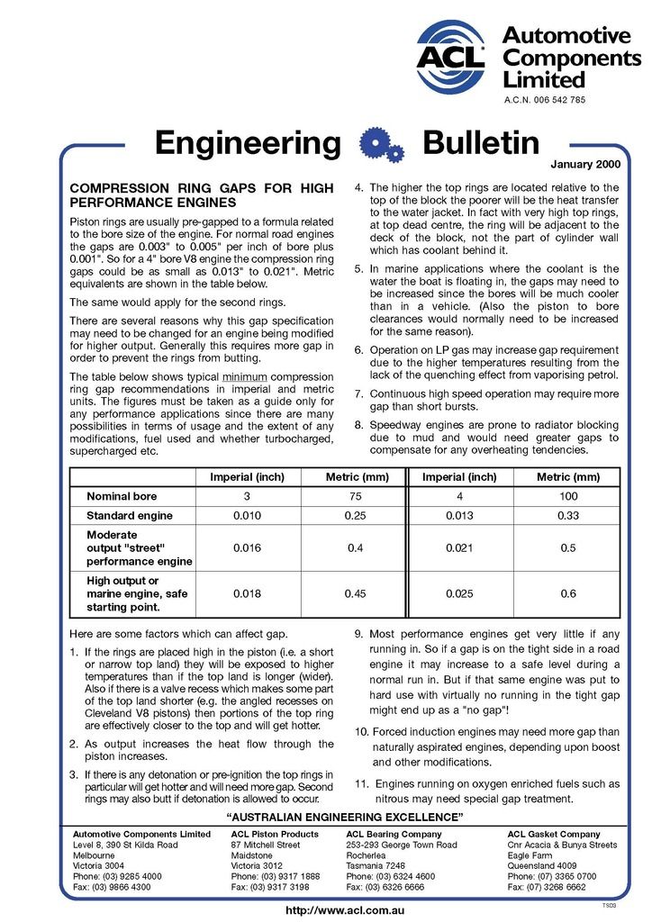

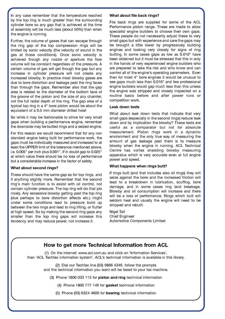

ACL who did manufacture Rings, give 0.003" to 0.005" per inch of bore for 'Normal' street use Engines, however there are variations to this and this Tech Sheet gives some guidance;-
Piston%20Rings%20for%20Performance_Page_
None the less, you would be wise to contact the manufacturer of the Rings you have a seek their guidance.
