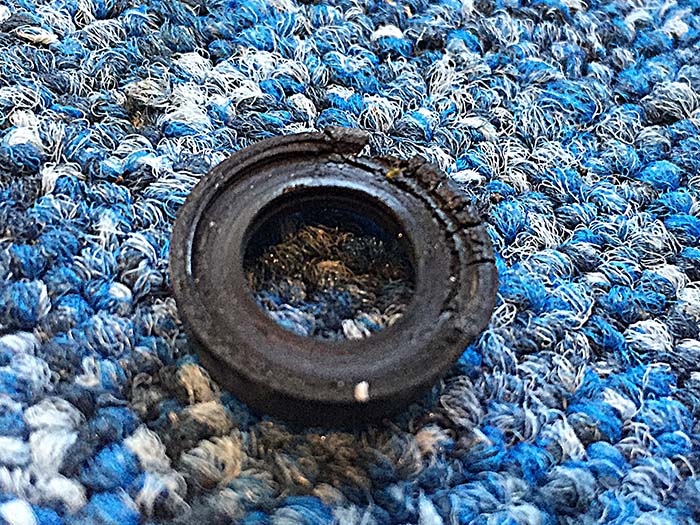

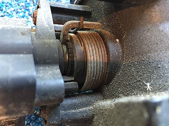

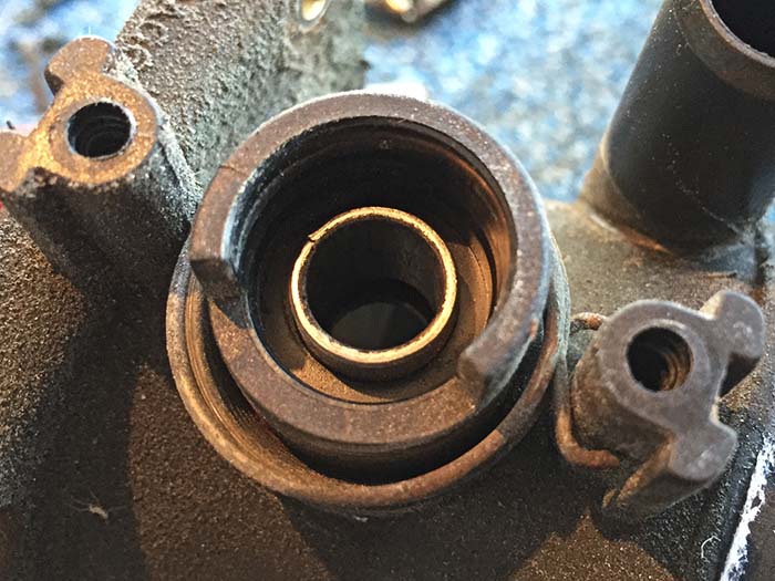

With that job done I decided to take the old carburettor out of the car and have a look to see if there was something wrong with it. Most certainly there was something wrong with it, as you can see from the picture below, this does not look quite right.
After stripping it down I found that the pressed bearing had not been pressed in at all during manufacture, and it had crushed the rubber O-ring against the spring hanger.
The O-ring seal was visibly damaged and was crumbling, letting presumably a lot of air in the at the wrong place.

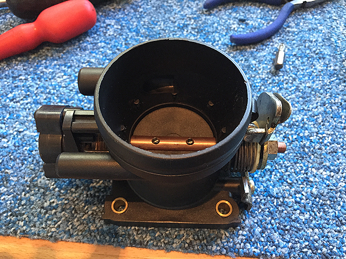

Here is the carburettor all refurbished and ready to put in.
Anyway the old one will be a job for another day to repair, with the new carburettor installed and the idle air control procedure performed I started up the engine and everything feels very nice and smooth.
The true test will be tomorrow when I go for a bit of a spin in the car and see what it is like when it’s warmed up.
