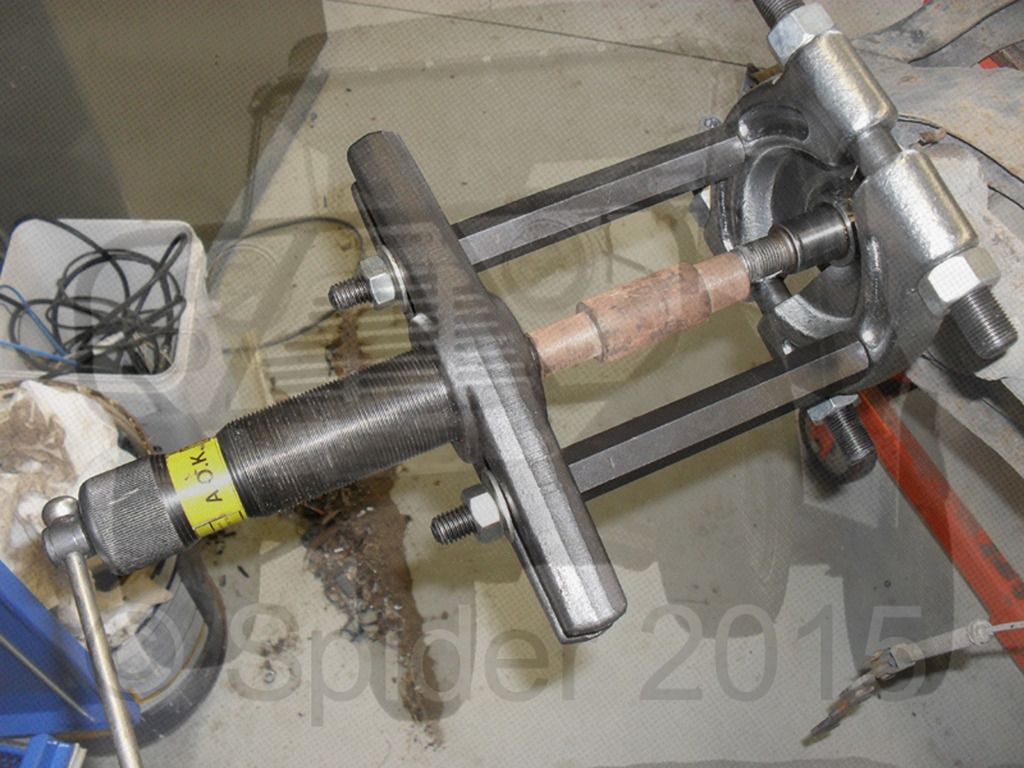

Try heating the race, but don't get it super hot (changing colour), just warm it basically. You can also try to split it with a decent chisel, but wear a full face safety sheild if you do. The race is hard and could well shatter in a big way. Also be careful that you don't damage the boss that the seal runs on doing this.
You can get a puller, but you'll likely need a split type, similar to this;-
although that's a hydraulic type, a screw type will also get the job done. The 2 and 3 leg types ate also good, but there's nothing on a race like yours for the legs to get a grip on until it moves about 1/2", by which time, it'll probably come off!
Once it's off, check and clean the stub of any ridges. The bearing should be a neat, slip on fit.
