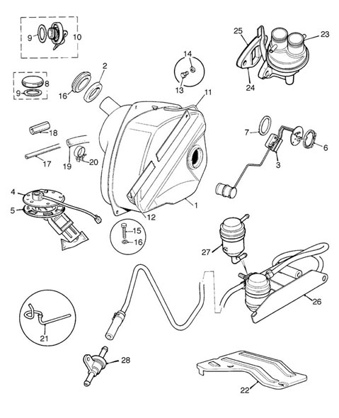

Sorry, what I broke was actually the fuel cutoff valve that sits outside the tank on the top. It is entirely made of plastic on the outside and I snapped the upper take-off right at the base. Doesnt seem to be sold anywhere. Its is 27 in this diagram.
So, I think I might have fixed it. What I did was to take a rear wheel cylinder bleed nipple, hack off the pointy bit without threads so that the hole goes straight through and out the middle. I drilled out the cutoff valve slightly and screwed the bleed nipple into it. Then covered the entire thing in epoxy. Hopefully it works.

pretty sure its not any sort of cutoff valve, the fuel cutoff is done via a resettable tumbler switch on the passenger bulkhead, under the bonnet. It basically sits in line with the power supply to the fuel pump and is tripped by shock (such as in a collision). Sure what you are referring to is a valve for the tank breather, which opens when fuel vapour in the tank creates pressure, and allows the vapour to go up to the charcoal canister under the wing.

This is what Mini Spares calls it:
27  WLV10007  Fuel cut off valve  1 1275cc CWE
Whatever it is, I hope I fixed it:-) It seems  to have worked as I installed yesterday. I used a bit of silicone sealer around the bleed nipple that I added onto it just to be sure the attached pipe seals and stays put. I guess we will see when I go to start the car and actually drive it if it all works out.
