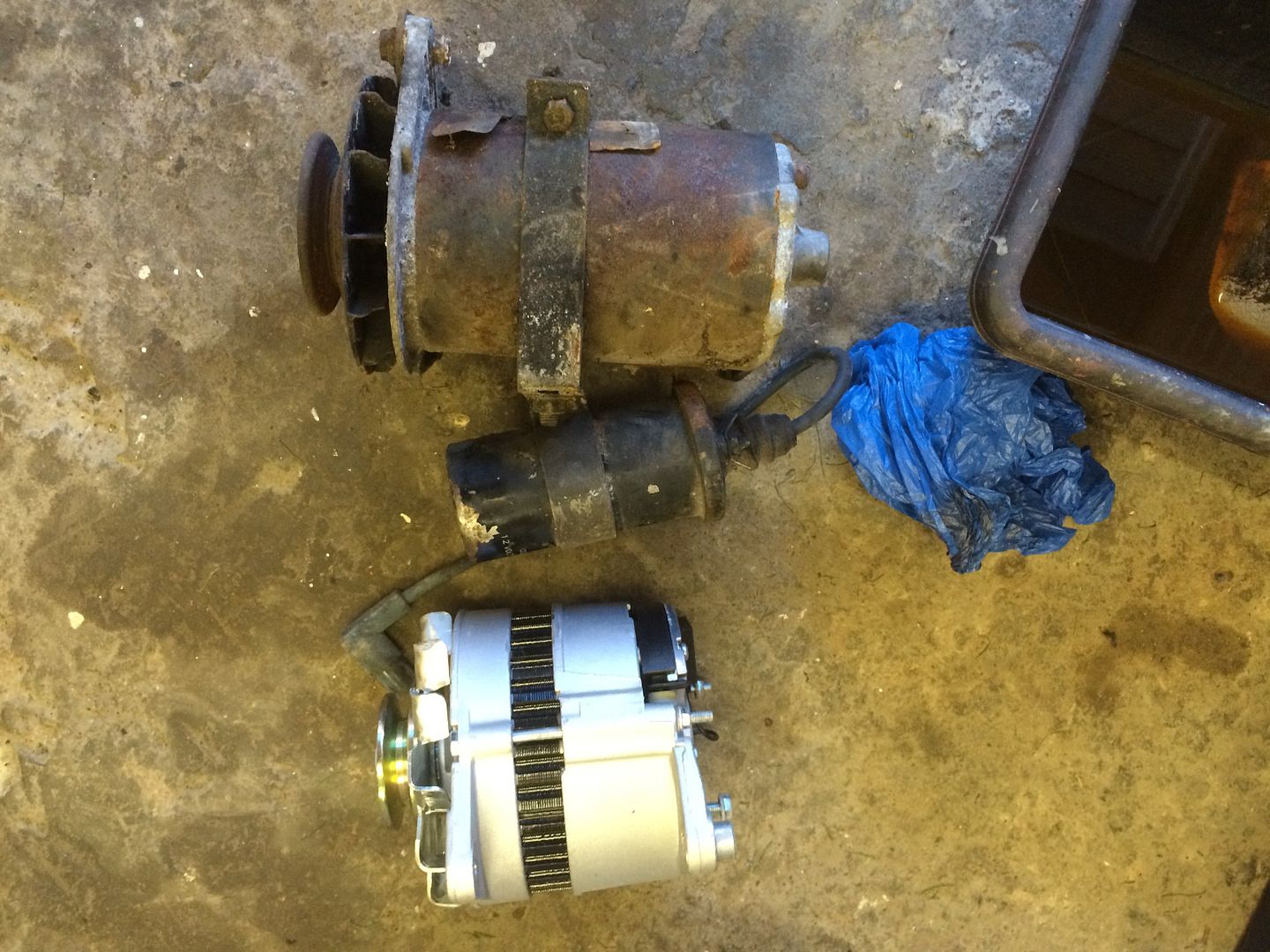

Hi I have the original Dynamo that was fitted to my mk1 engine but is it a good idea to change to a newer alternator? I have a brand new alternator I can use but the sizes are different is there a way of changing it? Thanks Tom 96967A9A-22F2-4542-A8A9-431A6F33993F_zps

There are advantages to the alternator but you must weigh your decision against how original you want the car to be.
Rather than repeat the process here I direct you to two tech articles at Mini Mania.  The first covers basics of how-to, the second discusses using an old dynamo control box as a junction box so you don't have to cut up the loom during this conversion.
http://www.minimania...on_Instructions
and
http://www.minimania..._Alternator_721
You specifically asked about "making it fit".  I presume you are concerned about the length difference.  That is handled one of two ways.  The cheap DIY method is to make a spacer up for the rear mounting point.  However, the neater way to handle this is to buy the alternator mounting bracket (part 12G1053) which will replace the rear support used with the dynamo.

Just to add I have change to an alternator on my mk1 bought the longer bracket required as the alternator is shorter and also followed the mini mania guide to convert the voltage regulator as a joint box to keep a more original appearance and a good way to hide the joints
