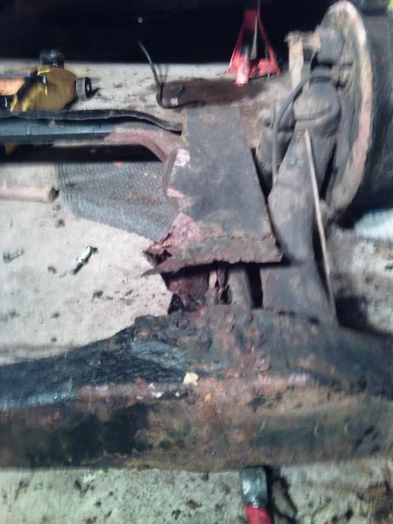

when i first bought my mini (9 years ago), i discovered a plate had been welded across a crack (on the bottom) and it passed every MOT (well it passed on that anyway)  right up until this happened....
Try another tester!

oof, that looks nasty, havent got mine off just yet, rounded off bolts  :goaway:

yup been there when i had to remove the subframe (about 5 years ago). Ended up finding rot in the heelboard as well :( When rebuilding, use plenty of copper grease. I removed my subframe a few months ago and it came off really easily thanks to the copper grease!
