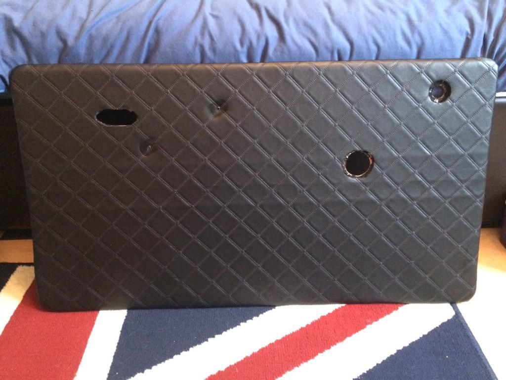

i have just done my door cards in this material i put some 5mm foam behind the vinyl to give it some padding, its not quite finished yet tho :)
Looks brilliant! What adhesive did you use?
i didn't, just wrapped the material around the door card and stapled it tight it worked a treat i found using an adhesive over time it comes apart and looks bad
