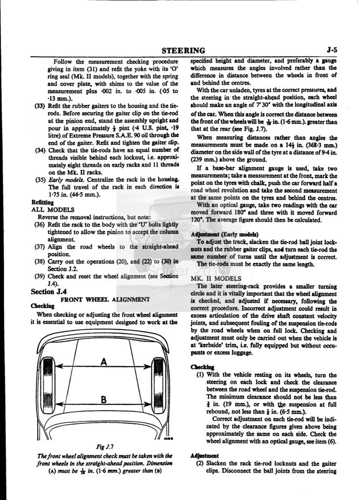

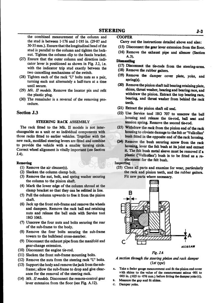

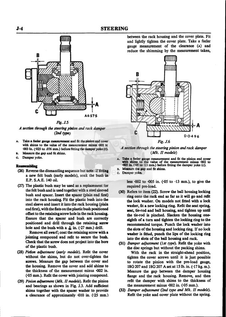

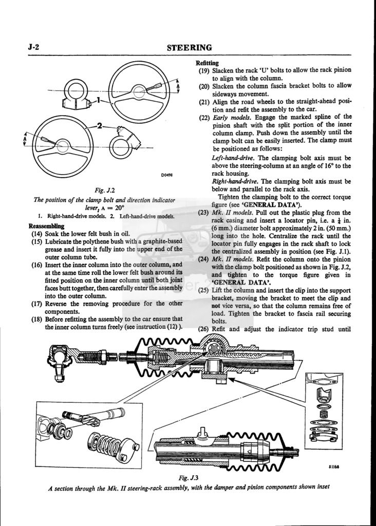

Here's the Factory info on how to overhaul it;-
UK%20Rack%20Overhaul_Page_1_zpskhz3rhwu.
UK%20Rack%20Overhaul_Page_2_zpsty4ihmw5.
UK%20Rack%20Overhaul_Page_3_zpspnxydc4d.
UK%20Rack%20Overhaul_Page_4_zpsdu0fyfgd.
This is the (crap) felt bush they fit in them
99% of all rack problems comes from this bush.
