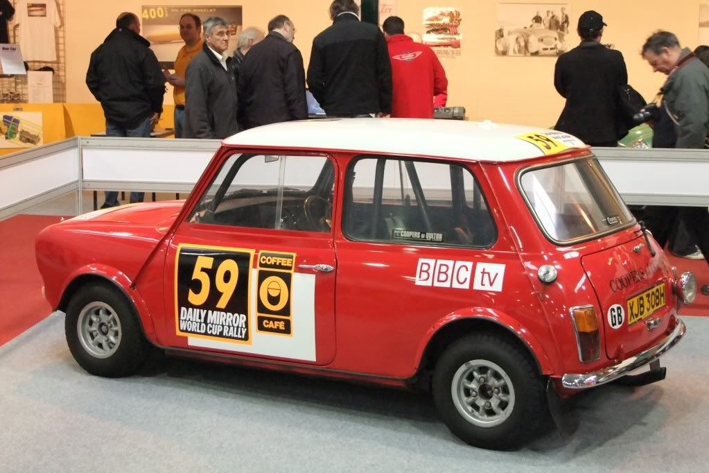

Here is the 'World Cup Mini' a Mk.3 door with sliding Perspex windows.
In view of the work needed, it can be easier and save just as much weight to fit Perspex/polycarbonate windows as direct replacement for the glass, fix them permanently closed and fit sliding square small windows into the larger ones.
