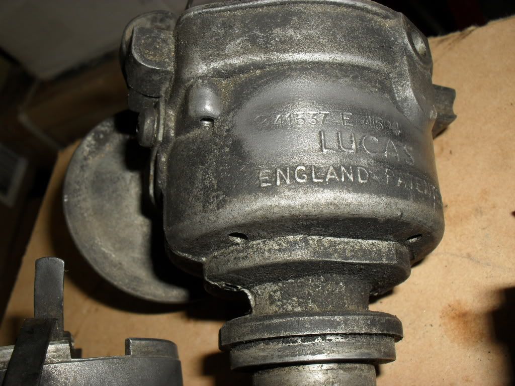

There will also be a 5 digit no. stamped on the body, it may also have some letters with it and usually the no. will start with a 4xxx, eg
41537
that is the number we need.

If you take the points baseplate off the distributor (2 screws) you can see the advance mechanism. There should be a number stamped on this, probably between 7 and 12. This number is the original amount of total mechanical advance, as distributor degrees. To work out degrees total advance at the crank multiply this number x 2.
So for a dizzy with 10 deg mech advance stamped on advance mech will be total 20 degrees at the crank. To work out the total max ignition advance add together the static advance to the total mech advance. If you timed points to open at 8 degrees static this would be total max advance of 28 degrees (without vacuum advance).
