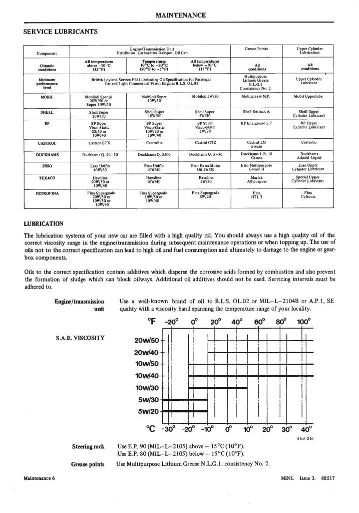

#9 Spider
Spider
  • 15,041 posts
  • Location: NSW
Posted 20 October 2015 - 07:33 PM
Ha, that's the thread I was thinking of as soon as I read the opening post, most impressive.
You may want to swap to a slightly thinner oil....maybe 10-40....not sure I'd go down as low as a 10-30
Also....ensure your choke is properly functioning and the fast idle cam is adjusted right ( if using an SU )
In regards to the Viscosity Grades of Oil, here's the Good Oil from the Factory;-
So, using the 'typical' 20W40 or 20W50 would in fact be harmful in those temps, a 5W30 or even a 5W20 is appropriate.
'Thicker' isn't always best.
Edited by Moke Spider, 20 October 2015 - 07:36 PM.
#10 Spitz
Spitz
  • 1,716 posts
  • Location: Saskatchewan
Posted 20 October 2015 - 07:40 PM
Not if running long trips.  I'd not go below 10-30 with a MINI.
Fine for an engine not running it's oil through a transmission also
This is why "block heaters" are important here.....so the oil / block is not actually -30 when it's -30 temp outside
