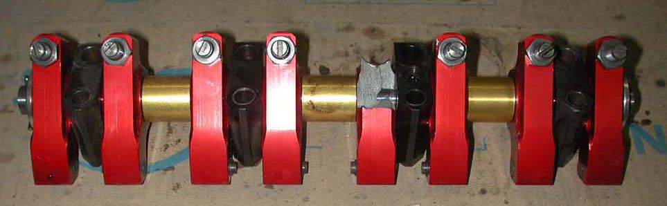

As I've got the head off, and just had the seats, guides and face machined, I'm wondering whether it makes sense to invest in roller tip rockers.
As its a 998, and not yet in a high state of tune (yet!!!) there consensus seems to be 1.3 rockers are ample, but they seem like an awefully large expense. The ones I've found so far are the best part of £600, and considering a large part of their benefit seems to be just to reduce wear on the valve guides, I can't see that as a justifiable expense.
Is there a cheaper option?

How about these ?
http://www.minisport...abs_description

That's A LOT cheaper!!!
There also seem to be mixed opinions on quality, though the negative comments aren't at all recent.
Thoughts?

We use the Minisport 1.5 rockers with double springs in SPi with no complaints at all after around 5 years. So, why not?

I have to say, if you're on a budget, I'd find it a bit hard to justify going to rollers. Cheap ones are just that.
Bhahaha,,,, yours must be 'duds' if they haven't broken yet
I lost track of how many ended up like that before swapping to MED ones and not an issue since.

I looked at MED but they told me they don't fit 998s.
I'm not on a really tight budget, but £50 just got me valve guides (on top of other machining) and £500+ for roller rockers, the maths kind of doesn't work.
