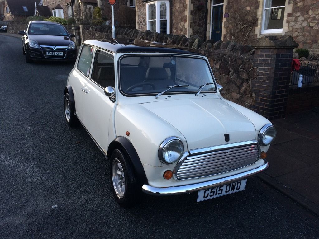

I was thinking of going arch-less but was unsure if my wheels would fit under just the trim, the tyres on the car are 165/60R x 12, with the standard plastic arches being fitted - the cars an '89 mini city e

 I can't tell what width yours are without further pictures, although they do look to have quite a dish on them (lower offset)

yeah, thanks for your input Cooperman and Joe, I, like many, adore minis with no arch extensions, but, unfortunately the time and effort of getting mine there is too substantial - as, by the looks of it, i may have to change the wheels - hard when you're a student!! i will check the actual rim width when I'm next home, but the look of the more narrow group 2's look very nice also, so best bet may be with those, especially as the standard holes will match up with those arches.
