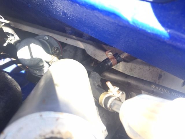

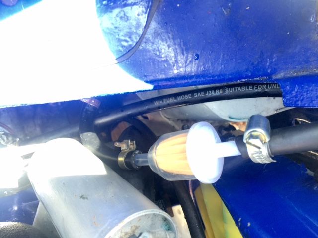

Hi all,
I know I have some fine stuff in the fuel tank I just cant get rid of so I have put one of these in to catch them.
I have looped the fuel lines in gentle curves to avoid kinking and tie wrapped it away from the exhaust manifold. Look ok as it is??
I have a glass and steel one to replace this after the initial tank flush which is cleanable but will wait for a while before fitting it.
Your thoughts/recommendations are appreciated.

#6 666junky
666junky
  • 1,225 posts
Posted 31 May 2016 - 06:23 PM
Be careful with those crappy plastic ones - mine popped off and fuel poured over the engine and exhaust.. thankfully it hadnt been running long. Found it very difficult to get any grip on the plastic once fuel was on it - any tighter and it crushed the tubes
#7 grahama
grahama
  • 2,442 posts
  • Location: Warrington
Posted 31 May 2016 - 07:36 PM
Sounds like a rethink is in order.

#13 dklawson
dklawson
  • 10,923 posts
  • Name: Doug
  • Location: Durham, NC - USA
Posted 01 June 2016 - 01:58 AM
You do want to use a coarse or large filter if you fit one between the tank and pump.  As Mokespider said, a small, fine filter can plug quickly from tank scale.  I had an electric pump burn up years ago from just that problem.
The glass filter shown under Mk1's car use a pretty coarse cloth type mesh compared to paper filter elements.  They are hard to clog and do provide filtration for the pump intake.  They can break.  I have one on my car and it is covered with a short length of foam pipe insulation to protect it from road debris.
The plastic type shown in Grahama's pictures are the type commonly used on air cooled VWs.  They have been used for years on a lot of British cars because they are compact and relatively inexpensive.  They are typically placed between the pump and carb intake.  I have never seen one fail.
